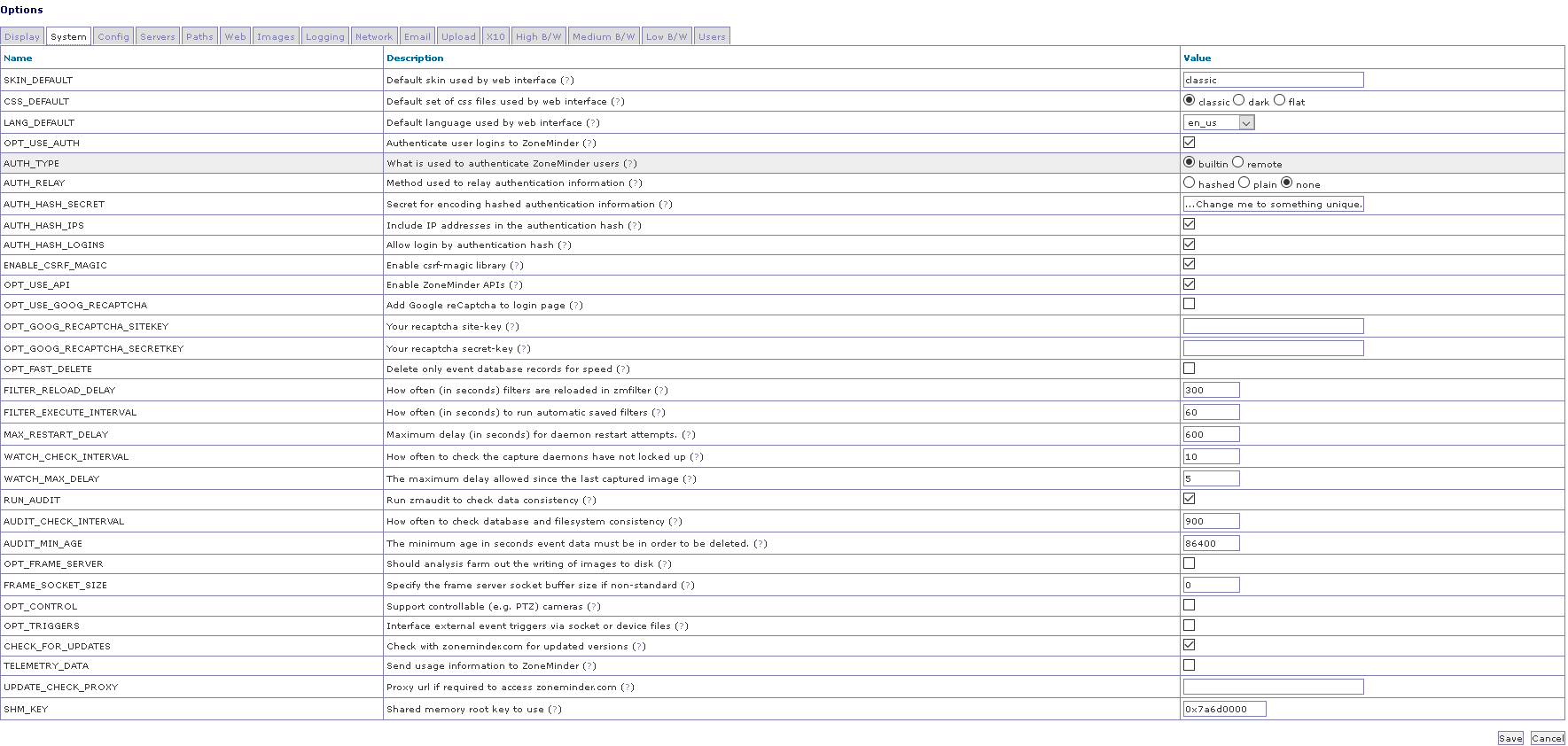

i tryed to upgrade againe, but its not helped.
I allso try to
zmupdate.pl -f
, but its not help
Recapcha option is disabled
