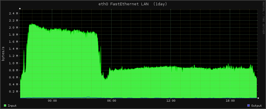

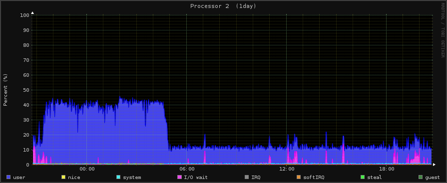

Is there a difference between a day and night bandwidth load?
Re: day/night IP bandwidth load
Yes, that is the reason for my post.
Read the first post carefully.
You can see the difference in IP traffic and one of four CPU load at attached Monitorix log pictures for 24 hours. From 19. to 20. 7. 2017.
You can clearly see, when the night mode with IR LEDs switch on (high IP traffic and high CPU load).
The most strange is, that the huge part of a traffic produce one camera of two. They are from different manufacturers.
Thinking of of a bug in that camera software.
I don't find it unusual that IP cameras would generate more network traffic at night -- cameras are noisier in low light, and unless the camera noise-reduces *before MPEG encoding*, you're going to see the results as lower compression, and hence, higher datarate.
In the day, the incoming light swamps the sensor noise and it's not a problem.
Yes sorry was referring to the spammer, should have been clearer, was on my phone and doing it quickly. Just wanted to leave something so you knew I deleted him and his post.
On topic yes the data stream is what the camera controls, CPU is probably zm coping with that increase in data. But it is interesting as I have seen this with cameras also, where night time resulted in larger files on passthrough.
CPU must kick up as a result, I was thinking it might work less as getting less compressed data. But then thinking about it more, I think it will be getting more pixel changes to have to decode.
