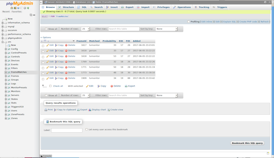

Re: I wrote an object-detection add-on for ZM
looks great and I think I am getting results!
I will try to find a place to integrate for experimentation.
tpcarmen
Posts: 17
Joined: Fri May 19, 2017 1:52 am
Post by tpcarmen »
Yep! Those are results all right! 8-)
Very cool, thanks for playing with it!
If you start picking up invalid detections, you can raise "thresh" in zmdn.conf. Probabilities that are less than "thresh" aren't INSERTed into the DB.

but for experimentation I would like to make a button or another column to select both views, one from zm and other after it runs through yolo. Also the FrameMatches table .... are the times synced with the event id and/or frame id? The FrameMatches table used in Filters as an added condition or reported in the notification email/message/push notification (in zmNinja). It all may not be practical, but fun to add and who knows?

rockedge wrote: Tue Jun 06, 2017 11:11 pm Also the FrameMatches table .... are the times synced with the event id and/or frame id?
Neither. The FrameMatches table is linked to the Frames Table on the Frames.Id = FrameMatches.FrameId
FrameMatches.Added is the time that the row was created, which would be when zmdn finished analysing the image and figured out what it contained.
