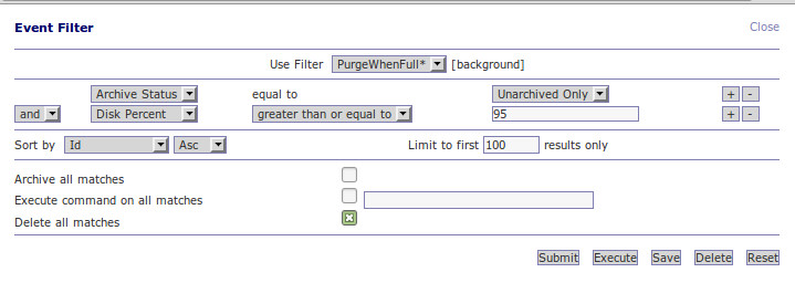

I have a filter to delete files when full
but clearly the disk is not full.

What is the size of your disK?
Are you doing continuous recording with high resolution cameras? If so your disk could hit the 95% full mark and Zoneminder deletes records from the database 100 at a time and zmaudit does not catch up deleting the files so the system thinks that it needs to delete more records and etc. When things finally catch up there are a lot of files to delete and you end up with what you have. If this is the case slow the camera frame rate down to 5 FPS and lower the resolution. Uncheck OPT_FAST_DELETE to delete records and images at the same time.
