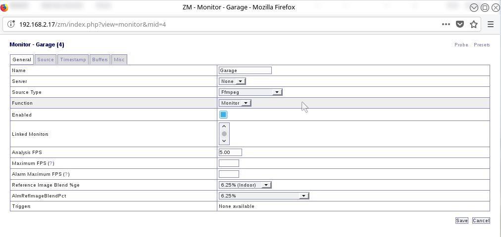

jimkoh
Posts: 51
Joined: Mon Nov 20, 2017 1:13 am
Re: Noob First Time Install - No Video
Post by jimkoh »
I made the changes to mimic yours and the best I get is a blue screen in IE that shows the time/date with numbers counting, but no picture. You must have a different version then 1.29 because I don't have all the options you do. I'm attaching 2 screenshots showing my settings.
