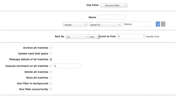

I tried a few different filters, but I just ran this:
MSG Filter Selection.jpg (28.2 KiB) Viewed 3776 times

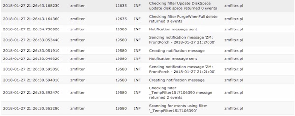

But also did this:
MSG Log.jpg (44.6 KiB) Viewed 3776 times

I first ran into the problem in my "production" installation when I upgraded to 1.31.28.
This (from the Filters table) which was functioning as I expected a few versions ago:
 {"terms":[{"attr":"Cause","op":"=","val":"Motion"},{"cnj":"and","attr":"MonitorId","op":"=[]","val":"6,7,8"}],"sort_field":"Id","sort_asc":"1","limit":""}
Tried to send me a message for every event from every monitor (2,3,4,5,6,7,8) . . . but that is still 1.31.28~20180125091522-xenial.
Thank you for taking the time to look at this.
