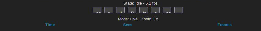

If you want to add this to your checklist
Monitor buttons graphics shifted
Posts: 3403
Re: Where did green dots in zone editor go
Uh... mine doesn't have buttons in watch... uh oh..
Posts: 3403
Oh.. you only get them with StreamReplyBuffer... which I have turned off. Sigh.

Controls - fixed in latest PR. dark skin is evil. Green dots - don't think I touched it.
