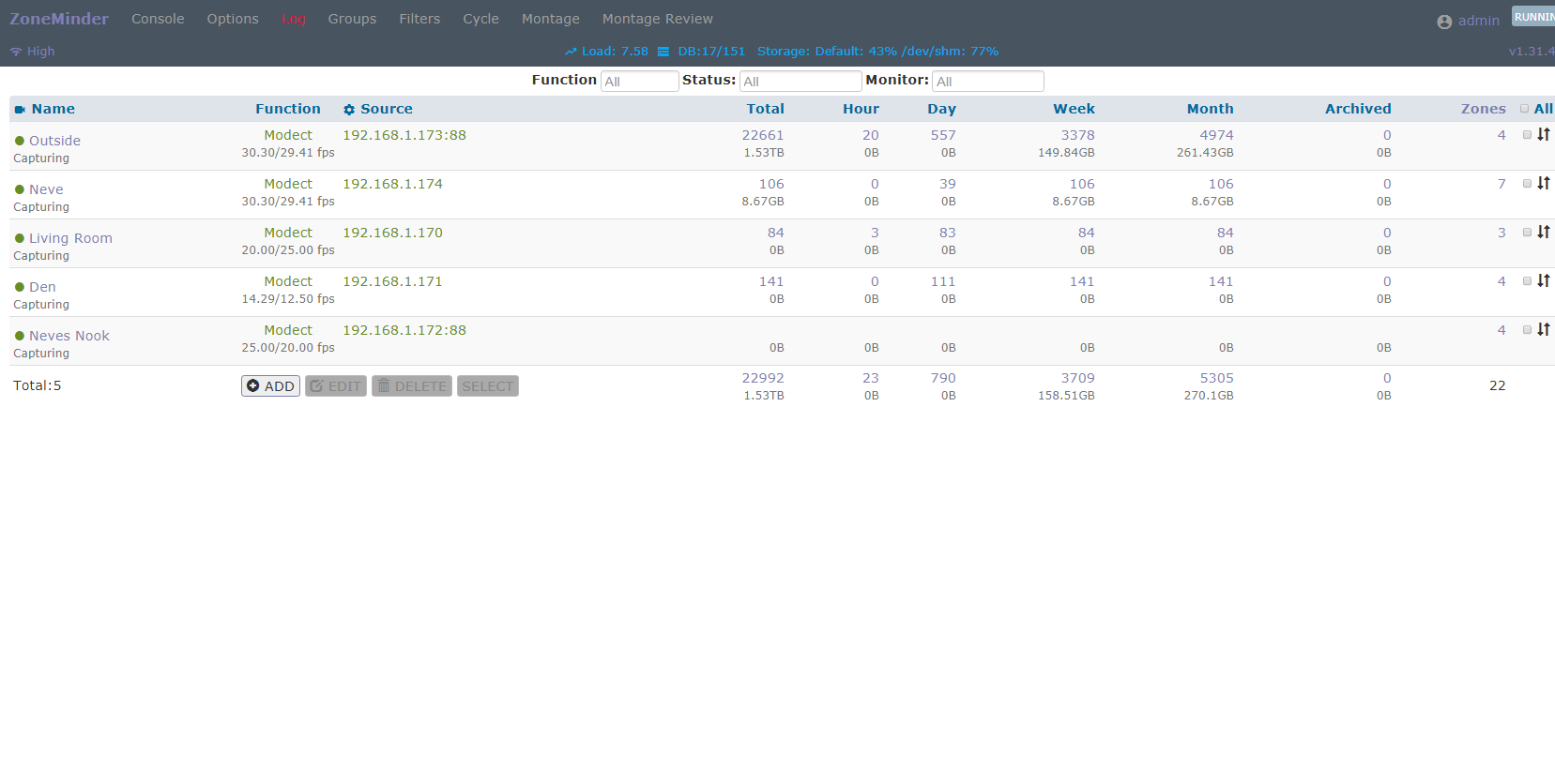

Also any recent events are not showing as taking up any space on. See below image. The older events that were before the update to 1.31.40 are showing up as taking space. But are also not viewable.

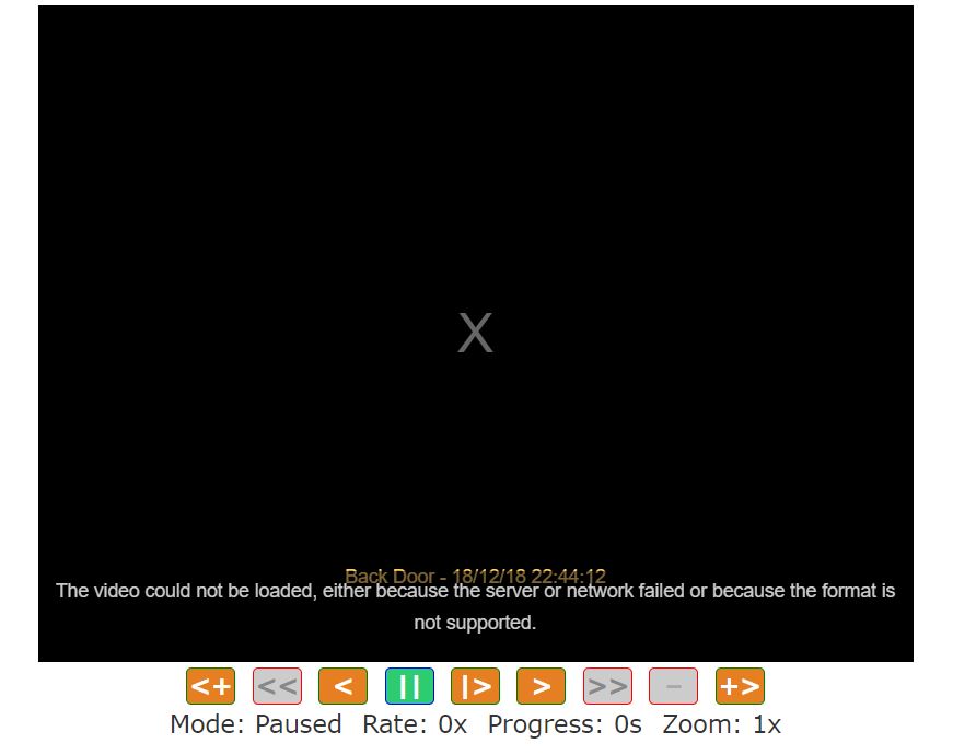

I'm having the same issues as everyone else. Some events work fine, and others don't. See attached. Running 1.32.2 on Centos 7. It's very frustrating!
