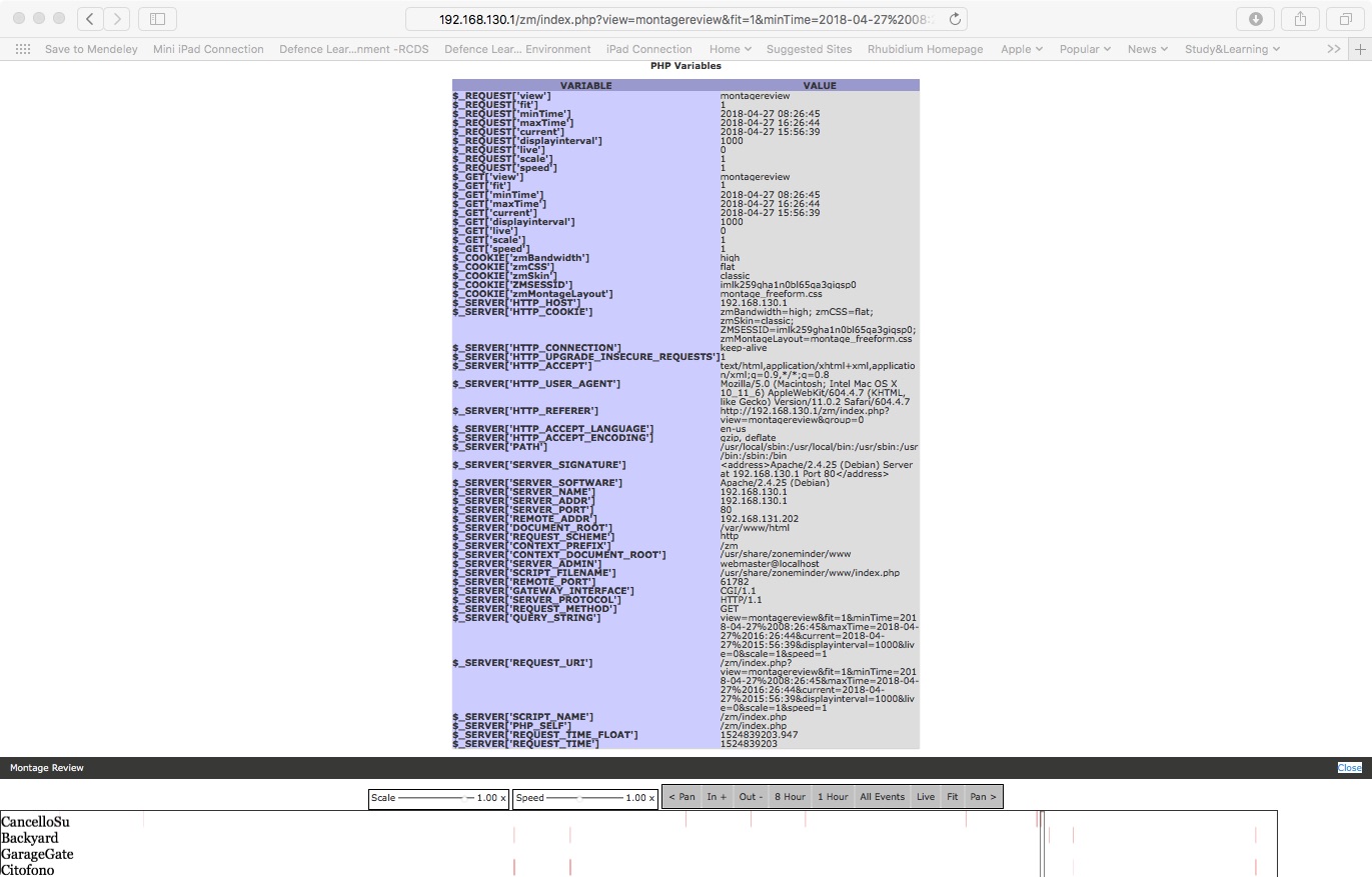

Some additional Elements:
in montage review, when reviewing events and the time cursor is on the events these lines appear in the event log:

Montage review does not work
Hi Rockedge,rockedge wrote: ↑Wed Apr 25, 2018 4:06 pm Hello fsardone!
To keep the monitors on the time line easier to see individually you can change the color assigned to the camera monitor. Open a monitor settings window and select the "Misc" tab and modify the Web Color from red to some other value. Now in the timeline view each block of events attached to a monitor will be easy to follow by it's assigned color. Red is the default value of Misc->Web Color
unfortunately that is not the issue. I get "No Data" white screens in the montage review, even when there are events present.
I see the events in the timeline, I see no video when the cursor overlaps the marked events.

Hello everybody:
in order to try and find out why I was getting the error in the log I tracked down the source code doing so and changed it in order to try to understand what path was wrong.
I changed the error text from Invalid to Xnvalid to validate my insertion point and appended the $path variable. The consequent errors I got into the log contain no text after the error message so I have to assume the $path variable is empty.
Also I defined the $debug=true variable and these are the system variables.
Any suggestions why the Montage review is not working and the $path variable is not being set?
Does Mintage Review works fine for everybody else using debian?
Fabio
# If we are only specifying fid, then the fid must be the primary key into the frames table. But when the event is specified, then it is the frame #
$Frame = new Frame( $_REQUEST['fid'] );
$Event = new Event( $Frame->EventId() );
$path = $Event->Path().'/'.sprintf("%'.0".ZM_EVENT_IMAGE_DIGITS.'d',$Frame->FrameId()).'-'.$show.'.jpg';
} else {
$errorText = "No image path";
} else {
$dir_events = realpath(ZM_DIR_EVENTS);
$path = realpath($dir_events . '/' . $_REQUEST['path']);
$pos = strpos($path, $dir_events);
if($pos == 0 && $pos !== false) {
if ( !empty($user['MonitorIds']) ) {
$imageOk = false;
$pathMonId = substr( $path, 0, strspn( $path, "1234567890" ) );
foreach ( preg_split( '/["\'\s]*,["\'\s]*/', $user['MonitorIds'] ) as $monId ) {
if ( $pathMonId == $monId ) {
$imageOk = true;
break;
if ( !$imageOk )
$errorText = "No image permissions";
} else {
$errorText = "Xnvalid image path" . $path;
2018-04-27 16:38:17.555639 zmc_m2 3804 INF CancelloSu: 1698000 - Capturing at 10.00 fps zm_monitor.cpp 3125
2018-04-27 16:38:08.960837 zma_m3 930 INF Backyard: 1923000 - Analysing at 10.00 fps zm_monitor.cpp 1296
2018-04-27 16:38:07.327630 web_php 16368 ERR Xnvalid image path /usr/share/zoneminder/www/views/image.php 132
2018-04-27 16:38:07.095368 web_php 16368 ERR Xnvalid image path /usr/share/zoneminder/www/views/image.php 132
2018-04-27 16:37:41.309877 zmc_m5 3778 INF Citofono: 2556000 - Capturing at 14.93 fps zm_monitor.cpp 3125
2018-04-27 16:37:31.832120 zma_m4 932 INF GarageGate: 1915000 - Analysing at 10.00 fps zm_monitor.cpp 1296
Fabio
- phpVarMontageRev.jpg (198.18 KiB) Viewed 5821 times
