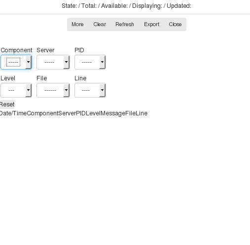

Zoneminder config file for Apache is configured as noted on previous posts here and also confirms to:
Grant access to the new cache directory in Apache on Ubuntu (#2130):https://github.com/ZoneMinder/zoneminde ... e40f4ae5ef
The web interface is a total mess. CSS skin is always the same regardless of settings. Non workable buttons e.t.c. .
Even Zoneminder log is empty.
By accident I discovered "solution" - set Zoneminders cache folder inaccessible to Apache (root/root), and :D suddenly all web interface have a working nice new look!
The downside of above cache folder setting are constant huge error logs.
All menus work, so I do not understand what is the use of a cache folder?
One time I forget to delete files in that cache folder after chown root/root. On my surprise GUI did not worked. It worked again after files there were deleted.
Must confess, that this is very strange behavior.

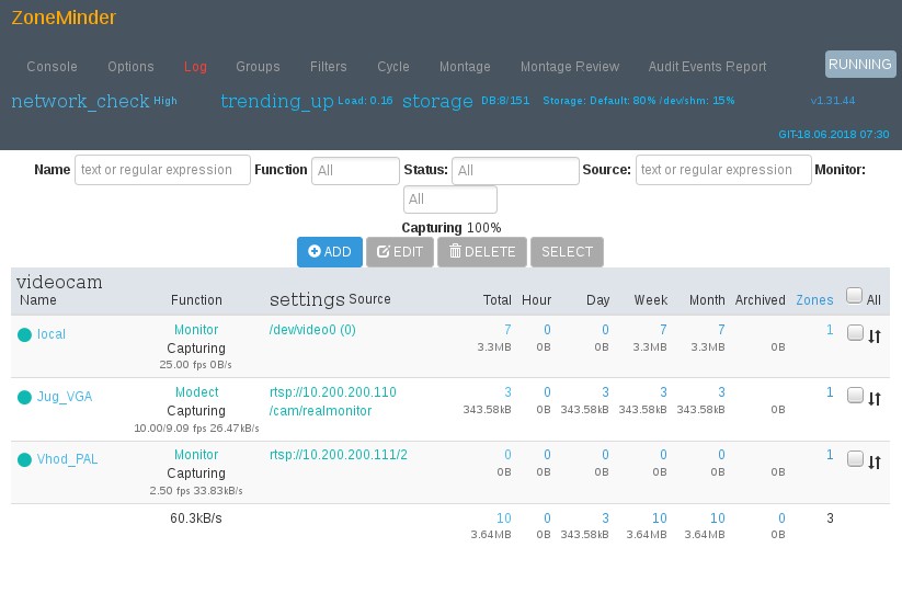

The new skins are really nice. The only complain from me is poor visibility of menus and status at lower contrast - high environment light on monitor.
See my last screenshot above - Grey and blue letters on black background.

I can also add that changing the url from http//:localhost/zm to the ip of the localhost pc do not change anything:
GET http://192.168.10.56/zm/cache/skins_cla ... 760722.css 404 (Not Found)
192.168.10.56/:14 GET http://192.168.10.56/zm/cache/skins_cla ... 760722.css 404 (Not Found)
192.168.10.56/:16
ect...
EDIT
above 404 error i think is because the alias in this example i wrong.
See below in other post, a 403 error with Alias /zm/cache "@ZM_CACHEDIR@"
as the right path , but permission error
