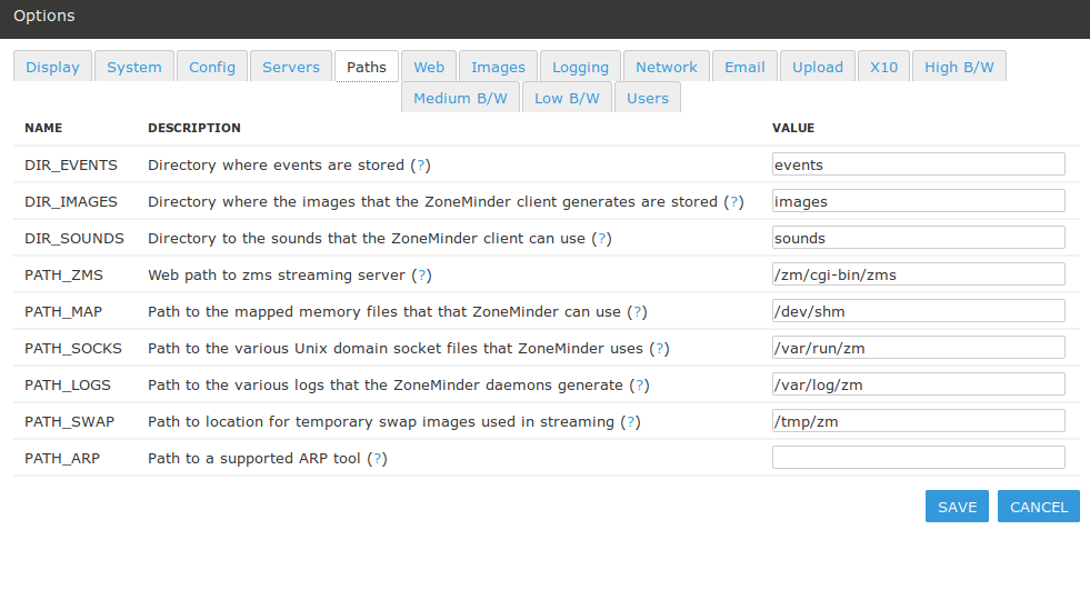

- zm_issue.png (53.26 KiB) Viewed 16116 times

In a perfect world, I'd rather we all switched to nginx. Unfortunately, I don't use it as much as I want to, though.
Looking at the screenshot shown in an earlier post, PATH_ZMS is not set correctly.
Value of PATH_ZMS from the sreenshot: /zm/cgi-bin/zms
What is should be set to: /zm/cgi-bin/nph-zms

Sorry for the delay, I had gone out of town for a few days. Anyway, back to respond to this. thank you for taking some time here Knight.
1. Value of PATH_ZMS was currently /zm/cgi-bin/zms due to me having tried multiple things. I see that when looking at the /usr/lib/zoneminder/cgi-bin/nph-zms that it is simply a symlink to /usr/lib/zoneminder/cgi-bin/zms so i was trying many things to get this to work including changing the path.
-rwxr-xr-x 1 www-data www-data 1271072 May 9 2017 zms
lrwxrwxrwx 1 www-data www-data 3 May 9 2017 nph-zms -> zms
2. I have reset the PATH to /zm/cgi-bin/nph-zms. The problem continues.
3. I saw that the path actually had a space on the end in the config, not sure if that could cause an issue, i removed that and have confirmed it does stay removed after saving. The problem continues.
4. I have checked many permissions throughout the system and they all look good. Anything questionable i went ahead end gave read permissions to www-data, just in case. The problem continues.
5. To double check cgi i created a test.php and confirmed cgi does indeed return info. The problem continues.
6. I can't think of much else to check. After restarting all of nginx and zoneminder, the problem continues.

For the distro you are using, /zm/cgi-bin/nph-zms is the only correct value for PATH_ZMS with no trailing spaces when doing normal streaming. Don't be confused by the symlink. zms knows how it was called, and will do something different if it was executed as just "zms" rather than "nph-zms".
The problem you are experiencing is definitely related to your webserver configuration. The error you are receiving is not caused by file permissions or anything else.
