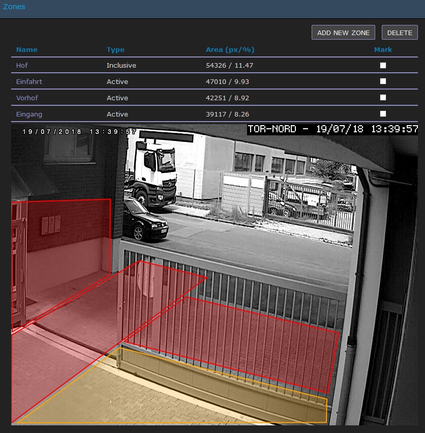

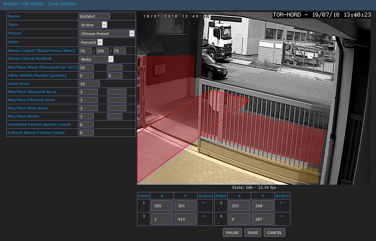

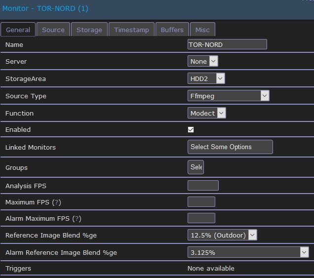

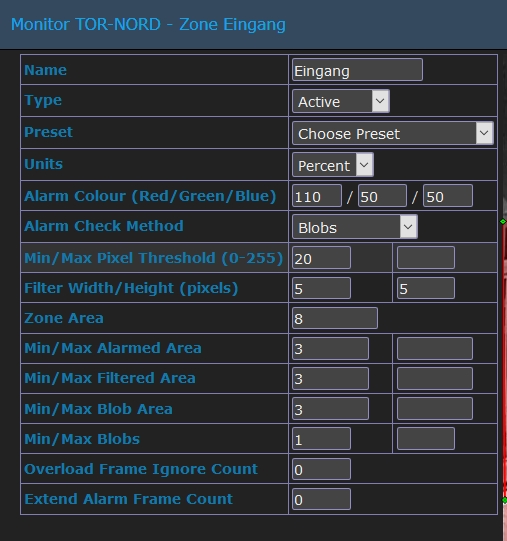

I am running a copy of zoneminder version 1.31.44 on a CentOS7 with 9 monitors. I have setup the monitors with zones for alarming and for motion detection. So far so good ... :P
When an event is triggered & recorded I can sometimes watch what happend and what was recorded. Often I just only see a short record of what happend, or even just a still.
Being neither a zoneminder or linux pro I am not sure what the issue is. I have looked into the performance of the system but it seems to be fair enought for me. Find some stats below ...

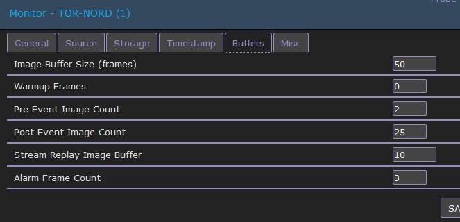

The cameras are connected using Ffmpeg, TCP, 800x592 8Bit greyscale. For testing I rised the buffer values,
Image Buffer Size 90
Warmup Frames 2
Pre Event Image Count 2
Post Event Image Count 5
Stream Replay Image Buffer 5
Alarm Frame Count 1
Zoneminder Shows the following stats: Load: 4.33 DB: 217151; Storage Default 11% HDD2 1%,; /dev/shm: 11 %

Dear knight-of-ni,
thanks for your advice. Even though I read the guides earlier I looked into my setup of the zones - and what can I say I changed it again and it seems to work way better now. I used to have multiple zones on all of the monitors. Reviewing some of the events it showed that the capture was interrupted when an subject/object traversed through the zones. So i removed some, and looked a the values for alarming. Since it is captured by an older PC it seems fair enough now.
Cheers mate, I owe you a beer :D
2018-07-19 13_39_26-ZM - Monitor - TOR-NORD.jpg (76.74 KiB) Viewed 8158 times
2018-07-19 13_39_11-ZM - Monitor - TOR-NORD.jpg (137.26 KiB) Viewed 8158 times
2018-07-19 13_38_34-ZM - Zone.jpg (525.13 KiB) Viewed 8158 times

...the rest of the screenshots which wouldn't upload ...
2018-07-19 13_38_09-ZM - Zones.jpg (432.23 KiB) Viewed 8152 times
2018-07-19 11_33_02-ZM - Zone.jpg (134.87 KiB) Viewed 8155 times
