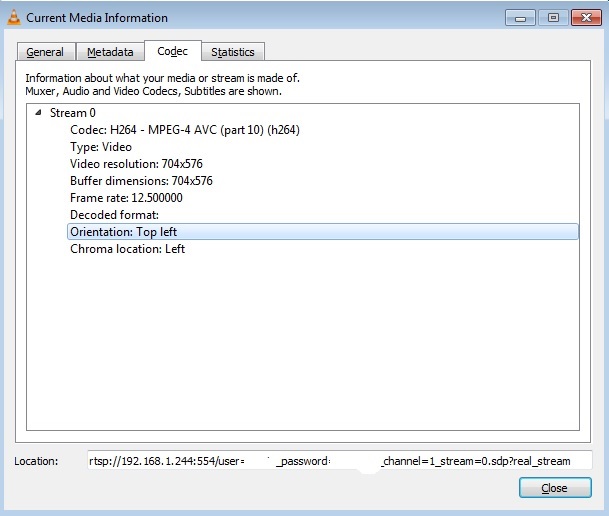

Camera resolution in Zoneminder does not match camera output. Use VLC (Tools, Media Information, Codec) to check camera Display Resolution.

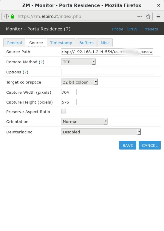

Vlc Codec Information:
ZM conf:
Thanks for any help.

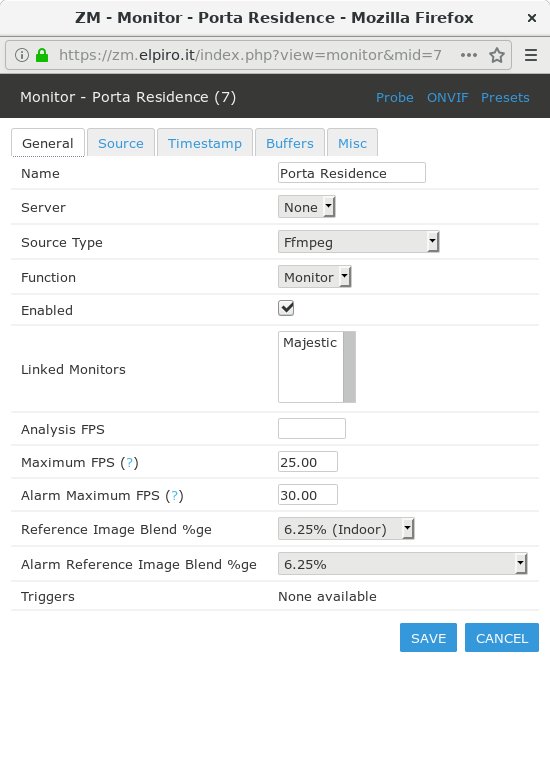

This is what I get:

Not able to help anymore than what has already been discussed here and in the other post, but you should not be setting maximum FPS rates for ffmpeg.
