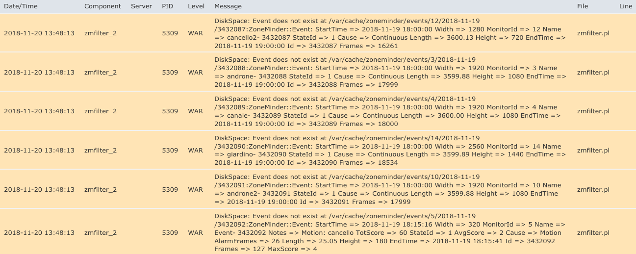

i recently updated from 1.30.4 to 1.32.2, and i get rid of almost all problems, but i still can't figure out whats happening here:
looks like the diskspace filter looks for events file on the wrong path, am i right?
I updated the events path both in OPTIONS/STORAGE and in /etc/zm/conf.d/zmcustom.conf, to an external partition with right www-data permission, but still i keep getting this error
DiskSpace: Event does not exist at /var/cache/zoneminder/events/12/2018-11-19/3432087:ZoneMinder......
what i am missing? thank for any help

You should post exactly what you put in zmcustom.conf and what your options->storage settings look like. Otherwise we are guessing.
Also, if you have added an entry in options->storage then you need to assign that to the monitor. It looks like the monitor is unassigned and so is using the default.

iconnor wrote: Tue Nov 20, 2018 2:22 pm Also, if you have added an entry in options->storage then you need to assign that to the monitor. It looks like the monitor is unassigned and so is using the default.
thank you, this solved it! I completely missed that part of the source config!
