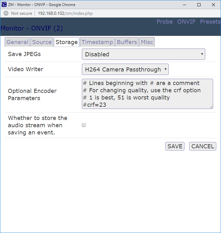

For everyone that is having issues with this in Freenas set your camera to the following.
Under the camera from the GUI click it
go to storage tab
select videoWriter as h264 camera Passthrough
Also note there is a new version of Zoneminder as a port for Freenas i recommend that it has a few little things fixed that you do not have to change
