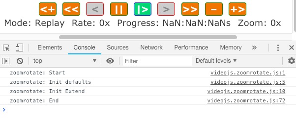

No javascript errors. Here's the whole console output when the event page is loaded:
zoomrotate: Start
videojs.zoomrotate.js:5 zoomrotate: Init defaults
videojs.zoomrotate.js:10 zoomrotate: Init Extend
videojs.zoomrotate.js:72 zoomrotate: End
enable-tooltip.ts:143 [Deprecation] HTML Imports is deprecated and will be removed in M73, around March 2019. Please use ES modules instead. See https://www.chromestatus.com/features/5144752345317376 for more details.
_init @ enable-tooltip.ts:143
Promise.all.then @ enable-tooltip.ts:69
Promise.then (async)
(anonymous) @ enable-tooltip.ts:64
(anonymous) @ enable-tooltip.ts:297
skins_classic_js_skin-base-1539455775.js:208 {result: "Ok", message: "	<div id="reload" class="container-fluid reduced-t…↵  </ul>↵    	↵<!-- End .footer/reload --></div>↵"}

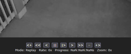

IMSancho
Posts: 6
Joined: Wed Oct 12, 2011 1:01 am
Re: After upgrade from 1.30x, seeing "NaN:NaN:NaNs" and other issues on events
Post by IMSancho »
I'm seeing the same issue on a fresh install on CentOS 7 from the RPMFusion repository. Nothing in the console, and I can watch events with the fast forward and rewind buttons, but play and pause don't work. Hitting pause makes the mode briefly flash to 'Paused' but immediately changes back to 'Replay'
Screen Shot 2019-01-28 at 9.43.25 pm.png (44.29 KiB) Viewed 13940 times
