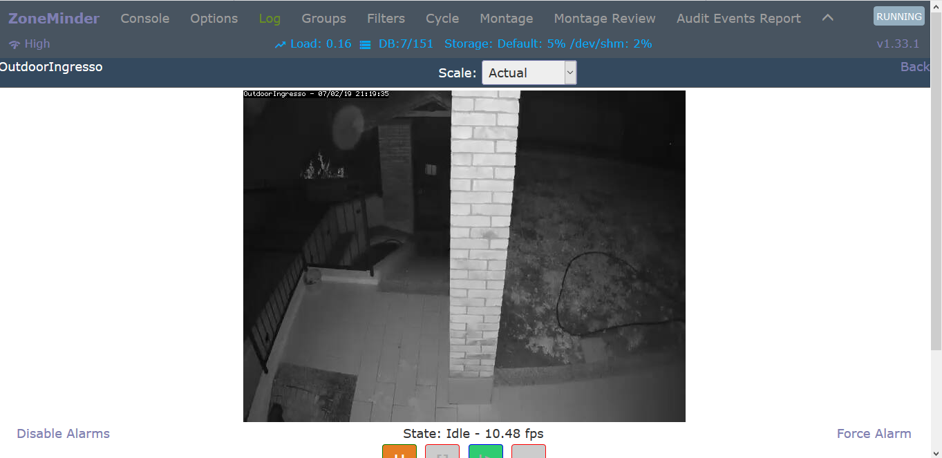

I started with Armbian (since you told me working) and I built the 1.33.1 package from source according to your recommendation. Then installed ZM. Then installed an ffmpeg camera. And it works!
It's possible to capture the ffmpeg stream and it's possible to see recorded images selecting "H264 Camera Passthrough" as Video Writer.
I want to try the same with the 18.04 Ubuntu image provided by Odroid wiki as you suggested. For my curiosity. Even if Armbian seems a good distro too: I have a jessie debian distribution on my Radxa (my second ARM board) and I like it..
Definitively 1.33.1 can work on ARM and ffmpeg. I will try with with the 18.04 provided by Hardkernel building the ZM package from source.
For now many many thanks. I will tell you about further experiments.
Moreover I learnt about how to build a ZM package. Again thanks a lot.
Michele

- Cattura.PNG (246.21 KiB) Viewed 28160 times

I have an interesting update.
With support of Odroid community the issue related to unavailability to capture FFMPEG streams is solved.
Rebuilding FFMPEG, forcing it to do not use h264_v4l2m2m, now it's possible to capture FFMPEG streams also using the 18.04 Hardkernel Odroid distro.
With the Armbian distro I didn't have the issue.
The remaning issue (still on Hardkernel distro, still on Armbian distro, still on ARM, still on my laptop) is when I try to see recorded images of MJPEG cameras (camera is configured as remote and in Storage: Save JPEGs= Frames only, Video writer= disabled).
I'm able to view the MJPEG stream, but not able to view a recorded MJPEG stream.
In the logs I'm getting the following message:
"Socket /var/run/zm/zms-251032s.sock does not exist. This file is created by zms, and since it does not exist, either zms did not run, or zms exited early. Please check your zms logs and ensure that CGI is enabled in apache and check that the PATH_ZMS is set correctly. Make sure that ZM is actually recording. If you are trying to view a live stream and the capture process (zmc) is not running then zms will exit. Please go to http://zoneminder.readthedocs.io/en/lat ... window-etc for more information."
Note: for the laptop i have a workaround: in Storage: Save JPEGs= Disabled, Video writer= X264 Encode. For ARM (= Odroid, Raspberry,...) no workaround.
Is it a bug on higher ZM versions? I found the regression on my ARM board and on my laptop. I don't have such issue on 1.30.4: ZM is able to reproduce a video from recorded JPEGs.
thanks
