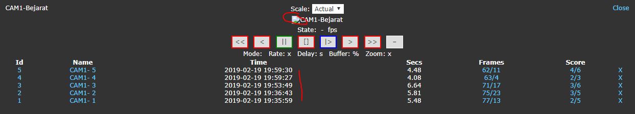

I had an older Zoneminder version running on my system without any problem (ZM v1.30.4.) but i made an upgrade to v1.32.3 as described. The new version wont start. Than i completely removed old ZM, and installed a fresh version. Now it's working, ZM recognises my cameras, settings are same as before. But i have no picture! I see a "broken" small icon everywhere where i could see my camera (live, recorded events, etc).
I checked everything i found about this on the internet, everything seems to be ok.
Linux is Ubuntu server 14.04.3
Please help, my system is so unusable now.
No live picture, no other pictures in web browser.
