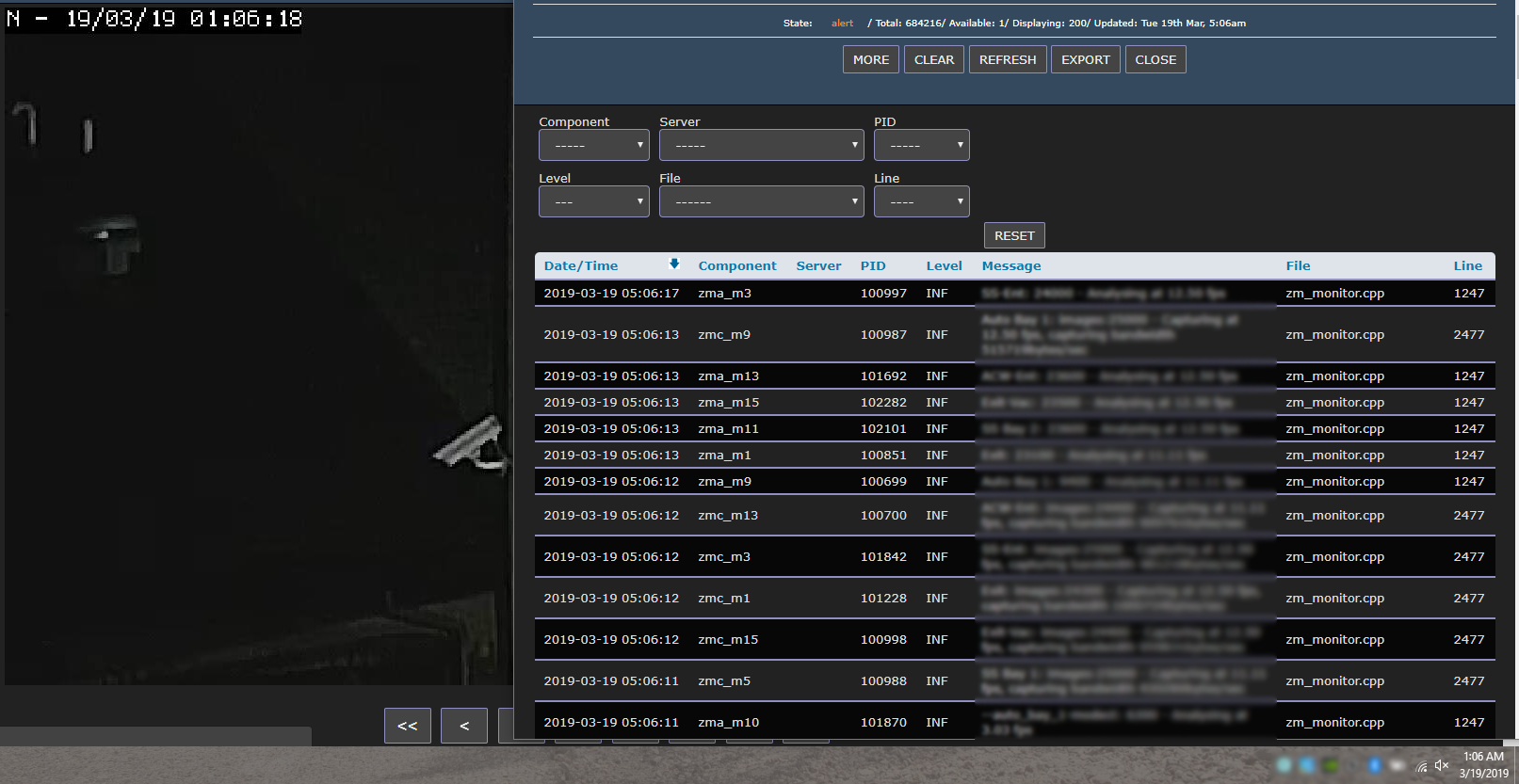

1. The first issue is related to the incorrect time being recognized in the logs. Although recorded events and live feeds show the correct time in the event list and on the event recording overlay, the time shown in the log section is off by 4 hours. I am located in the same timezone as New York. My timezone is and has been set correctly in FreeNAS and on my networking gear. I am thinking that this could be an issue with UTC being set somewhere, but I cannot find anywhere to change the timezone. I am not sure but maybe the MySQL instance has the wrong timezone set? Any thoughts on this?

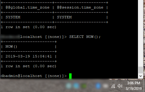

I logged into MySQL and checked the timezone and current time and it is being reported correctly by MySQL (the time is off by a few minutes, but this is more or less correct). I checked to see if I could change the "log_timestamps" variable, but MySQL reports that this variable doe not exist. Additionally, changing the my.cnf file as the referenced link suggested breaks MySQL.
I am thinking that there must be another variable or a different way to change this that won't break MySQL or ZM.
