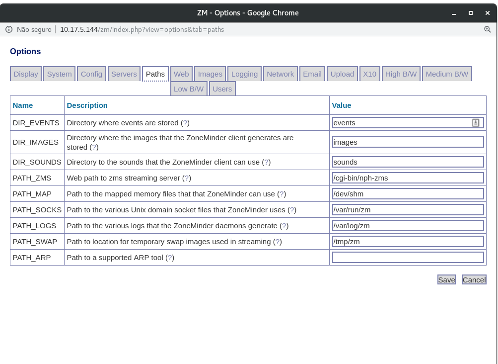

Hi!
I have the following problem. Zoneminder correctly recognizes only one camera. All cameras are exactly the same. I've already changed the paths, but it does not solve the problem. Anyone have an idea how to solve this?
I installed it in Debian, using the wiki step-by-step: https://wiki.zoneminder.com/Debian_9_64 ... der_1.30.4
I changed PATH_ZMS to /zm/cgi-bin/zms, but not work. https://zoneminder.readthedocs.io/en/la ... window-etc
My paths in attached png.
I do not know what to do anymore, I have already moved on everything I thought it could be!
Error:
getStreamCmdResponse stream error: Socket /var/run/zm/zms-211349s.sock does not exist. This file is created by zms, and since it does not exist, either zms did not run, or zms exited early. Please check your zms logs and ensure that CGI is enabled in apache and check that the PATH_ZMS is set correctly. Make sure that ZM is actually recording. If you are trying to view a live stream and the capture process (zmc) is not running then zms will exit. Please go to http://zoneminder.readthedocs.io/en/lat ... window-etc for more information.
Thanks!
robsonvitorm
Joined: Fri Mar 29, 2019 2:45 pm
Re: Does not display image
Post by robsonvitorm »
Solved after install libdvdcss2!
