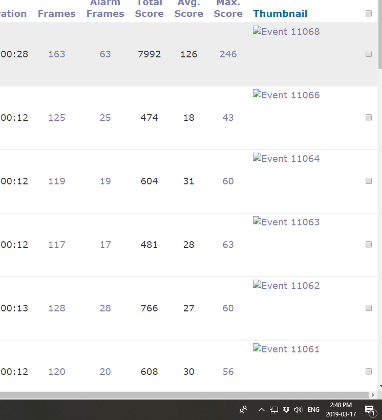

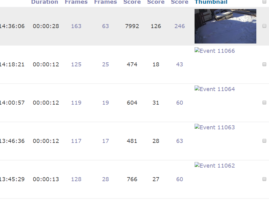

Im having issues with thumbs too after update from 1.30.4 to 1.32.3. i can see the thumbnails only if i put my mouse cursor over the event if no i see no pictures. heres a screenshot before and after i put mouse pointer over event. I not getting any error for that in zoneminder console too. Regret updating zoneminder zmninja was working fine and everything else too now now too many bugs and dont know how to fix

No my cpu is ok not high load or anything , i think something went wrong with update i don't know , will purge zonemider and do a fresh install of lamp and zoneminder i think its faster that way
update did i fresh install purging zm and database , after fresh install same problem no thumbs like in my screenshots

I found the solution had something to do with php versions and cakephp not working properly i dont undestand why but the solution was disable php7.1 and enable 7.2? :
a2dismod php7.1 a2enmod php7.2
