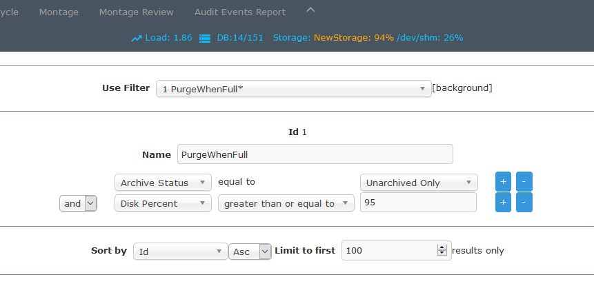

i´m using storageareas in ZM 1.32.3 for my records. Name is "NewStorage" and Path is "/data/zm". All works fine but now "NewStorage" is 100% full and the filter "PurgeWhenFull" won´t work. On manual running it give 0 results. I think ZM only check the default storage /var/cache/zoneminder.
On the other side when the default storage has reach the mark of 90% (mostly by database blowup) ZM delete all records on "NewStorage" because it can´t reduce the disk space of the default storage.
What can i do?

In 1.32+ I believe you have to add to the existing purge when full filter
This is probably only when you are using a storage area different from the default.
AND "storage area" equal to <storage area name>

The default purge when full function is unconventional due to the new ability to have multiple storage areas. From what I've read, it will by default sum up all the storage areas, and delete from all of them if they reach the percentage. But I often will start by making a second dedicated storage area for all cameras so what happens is the new storage area reaches 100% but the original doesn't. As a result, the total purge percentage may not reach the 95 or whatever percentage you set. What reportedly works is what is in the linked post above.

The PurgeWhenFull Filter has a simple AND linkage. More AND = more specific. If you delete the disk percent AND linkage it kills all exept archived. So i can´t understand that an extra AND will work in your posted link.

For clarity, until I figure out how to make it smarter:
If you don't specify a storage area, it has no information which area you care about. So it actually does a df on wherever the script is running from, which is normally /var/cache/zoneminder/events which is the age old default (under debian, redhat is different).
If you specify a storage area, then it looks there. It literally does a df path_to_storage_area.
Unfortunately the code needs to change a lot to enable just hitting all the storage areas. I keep taking a look at it and going down the rabbit hole and giving up. It might make it into 1.34 and it might not.
For now, just make a Purge WHen Full filter for each storage area.
