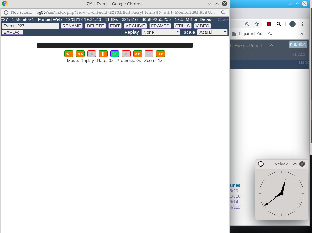

OK - Monitor is working fine, detection also recordings. When I do a playback all I get is a black bar and no playback. About 6 minutes later up it pops but won't run. Just the first frame showing. Nothing in the logs.
Re: ZM on RasPi 3B+
* what you mean by 'playback' what exact link/url are you clicking

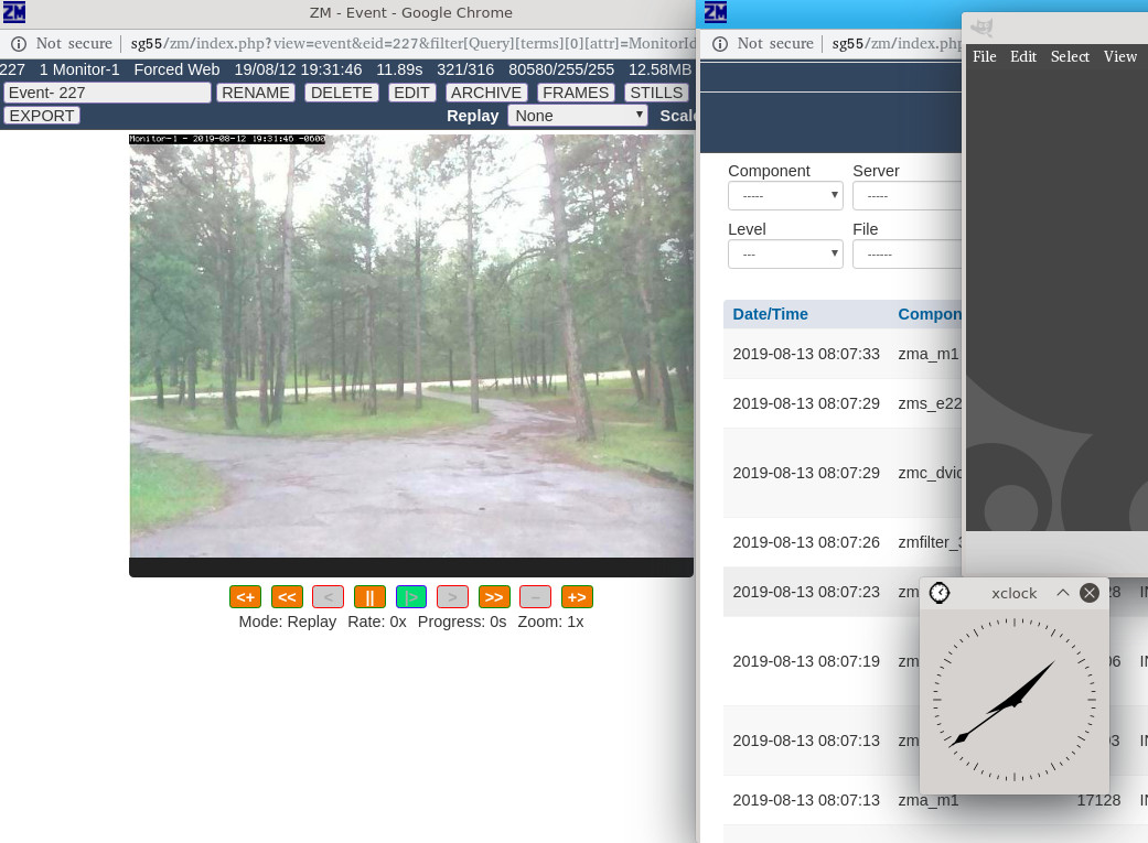

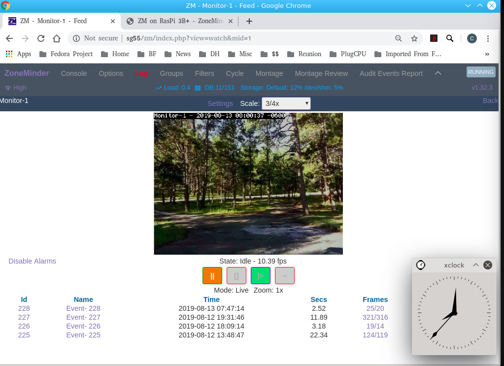

I have a "detection" see zm1.jpg Id=227 <click> see zm2.jpg - note clock
tick-tock-tick-tock.... see zm3.jpg note clock again.
Then if I click on "Play" - nothing happens. What is displayed in zm3.jpg is 00001-capture.jpg.

- zm3.jpg (152.08 KiB) Viewed 5527 times
- zm2.jpg (86.37 KiB) Viewed 5527 times
- zm1.jpg (151.77 KiB) Viewed 5527 times
