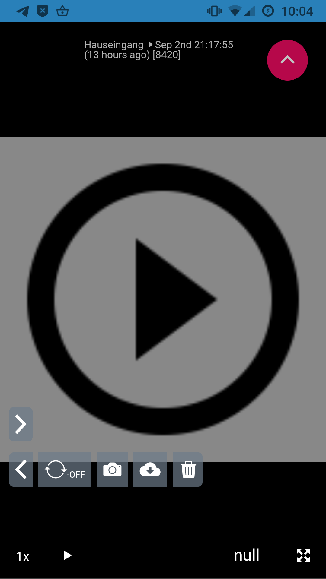

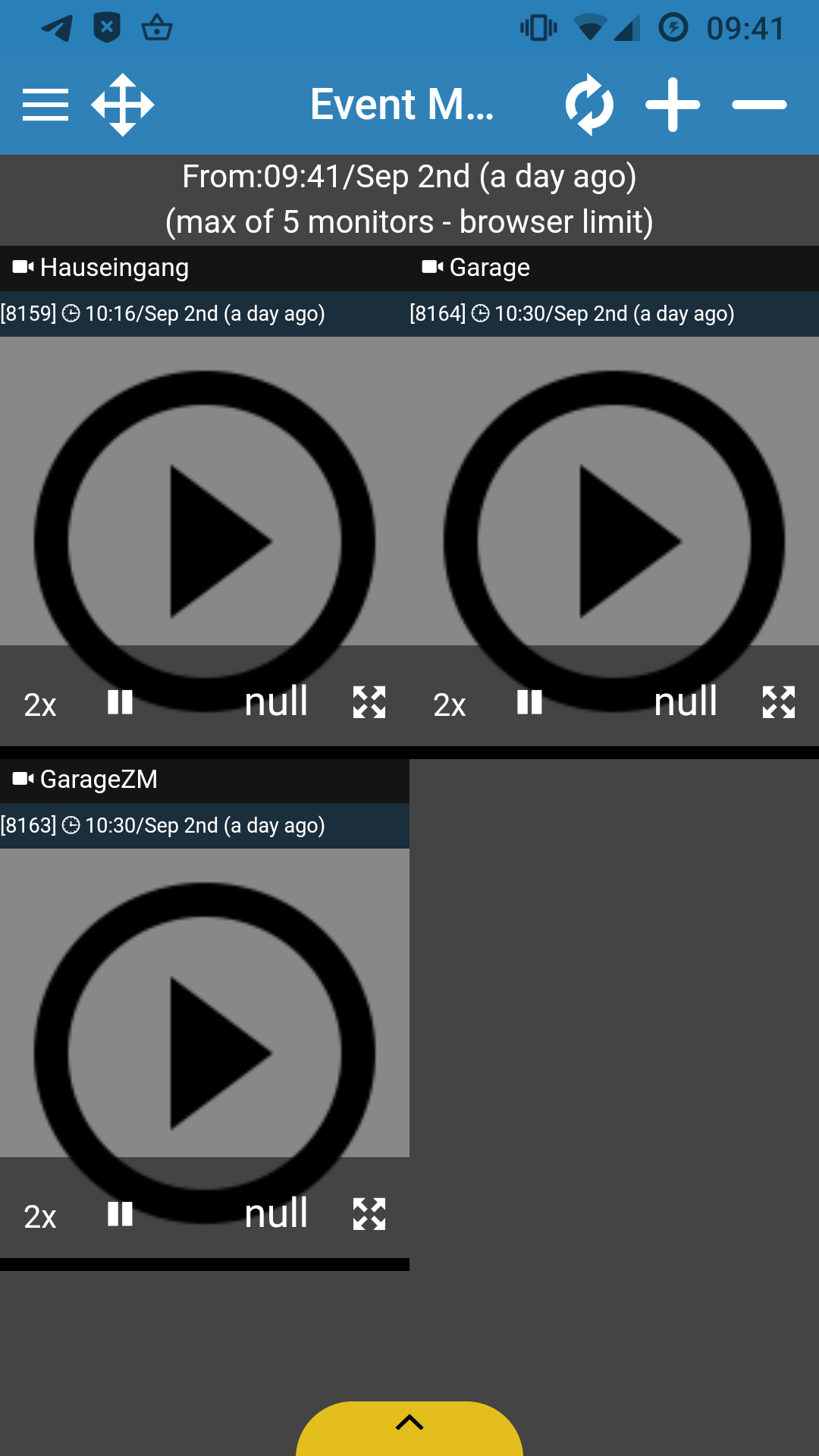

Changing AUTH_RELAY set to hashed and AUTH_HASH_LOGIN set to on did not fixed this issue on my site.
I am using an HTTPS connection with basic auth and zoneminder-builtin auth on a non HTPS standard Port.
Event Montage/List Events/24hr review is not working.
Temporary I disable the basic auth without success.
Zoneminder: 1.32.3
ZmNinja tried in differnet version started from 1.3.11 up to 1.3.078
calling the API Urls via browsers is working fine and as expected.

- Screenshot_20190903-094127_zmNinja.png (158.98 KiB) Viewed 24228 times
- Screenshot_20190903-100439_Trebuchet.png (123.63 KiB) Viewed 24228 times

Videos not playing are not related to APIs. Your logs seem to indicate there is a playback error.
1. Are you able to play the videos on your mobile browser? (Log into ZM Web Console from your phone)
2. Please send full Debug logs from the mobile when trying to play (please don't truncate)

Sep 5, 2019 11:05:59 AM DEBUG Storing streaming=https://zoneminder-schuetz.goip.de:55443/zm/cgi-bin recording=https://zoneminder-schuetz.goip.de:55443/zm
Sep 5, 2019 11:05:59 AM DEBUG Loading hidden/unhidden status for profile:
Sep 5, 2019 11:05:59 AM DEBUG Constructed Monitor Filter =/MonitorId !=:3/MonitorId !=:5
Sep 5, 2019 11:05:59 AM DEBUG Moments from 2019-09-04 11:05:59 to 2019-09-05 11:05:59
Sep 5, 2019 11:05:59 AM DEBUG Retrieving https://zoneminder-schuetz.goip.de:5544 ... larmFrames >=:1/MonitorId !=:3/MonitorId !=:5/StartTime <=:2019-09-05 11:05:59/EndTime >=:2019-09-04 11:05:59.json?sort=StartTime&direction=desc&auth=<removed>
Sep 5, 2019 11:05:59 AM DEBUG --------> attempting PAGE 1 of 3
Sep 5, 2019 11:05:59 AM DEBUG Expanding all images
Sep 5, 2019 11:05:59 AM DEBUG --------> attempting PAGE 2 of 3
Sep 5, 2019 11:06:00 AM DEBUG Expanding all images
Sep 5, 2019 11:06:00 AM DEBUG --------> attempting PAGE 3 of 3
Sep 5, 2019 11:06:00 AM DEBUG *** Inside native HTTP error for url:https://zoneminder-schuetz.goip.de:5544 ... ed>&page=4
Sep 5, 2019 11:06:00 AM DEBUG $q.all Parallel queries completed
Sep 5, 2019 11:06:21 AM DEBUG All images loaded
Sep 5, 2019 11:06:21 AM INFO *** PROGRESS WAS NOT CALLED
Sep 5, 2019 11:06:42 AM INFO Returning pre-loaded list of 5 monitors
Sep 5, 2019 11:06:42 AM DEBUG NVR: Regenerating connkeys for all monitors at 1567674402537
Sep 5, 2019 11:06:42 AM DEBUG >>Initializing connkeys and images...
Sep 5, 2019 11:06:42 AM INFO Inside MontageHistoryCtrl:We found 5 monitors
Sep 5, 2019 11:06:42 AM INFO Limiting montage to 5, thanks to max connection per domain limit
Sep 5, 2019 11:06:42 AM DEBUG Destroying masonry
Sep 5, 2019 11:06:44 AM DEBUG Inside footerCollapse
Sep 5, 2019 11:06:44 AM DEBUG fake call to footerCollapse - ignoring
Sep 5, 2019 11:06:45 AM DEBUG Calling footerCollapse from doInit
Sep 5, 2019 11:06:45 AM DEBUG Inside footerCollapse
Sep 5, 2019 11:06:45 AM INFO Local timezone conversion is on, converting from Europe/Berlin to Europe/Berlin
Sep 5, 2019 11:06:45 AM INFO Original From: 2019-09-05 00:00 Original To: 2019-09-05 11:06
Sep 5, 2019 11:06:45 AM INFO Converted From: 2019-09-05 00:00 Converted To: 2019-09-05 11:06
Sep 5, 2019 11:06:45 AM DEBUG **VIEW ** MontageHistory Ctrl Entered
Sep 5, 2019 11:06:45 AM DEBUG query timer started
Sep 5, 2019 11:06:45 AM DEBUG Killing existing streams, if alive...
Sep 5, 2019 11:06:45 AM DEBUG >>Initializing monitor array with history specific stuff...
Sep 5, 2019 11:06:45 AM INFO Grabbing history using: https://zoneminder-schuetz.goip.de:5544 ... /StartTime >=:2019-09-05 00:00/AlarmFrames >=:1.json?sort=StartTime&direction=asc&auth=<removed>
Sep 5, 2019 11:06:46 AM DEBUG Got 100new history events...
Sep 5, 2019 11:06:46 AM INFO Making sure all monitors have a fair chance...
Sep 5, 2019 11:06:46 AM DEBUG Monitor 3:Hauseingang-Innen does not have events, trying https://zoneminder-schuetz.goip.de:5544 ... /StartTime >=:2019-09-05 00:00/AlarmFrames >=:1.json?&auth=<removed>
Sep 5, 2019 11:06:46 AM DEBUG Monitor 5:Huehnerstall-1 does not have events, trying https://zoneminder-schuetz.goip.de:5544 ... /StartTime >=:2019-09-05 00:00/AlarmFrames >=:1.json?&auth=<removed>
Sep 5, 2019 11:06:46 AM DEBUG On Play Ready invoked
Sep 5, 2019 11:06:46 AM DEBUG Player is ready
Sep 5, 2019 11:06:46 AM DEBUG Re-creating packery and draggy
Sep 5, 2019 11:06:46 AM DEBUG All images loaded
Sep 5, 2019 11:06:46 AM INFO *** PROGRESS WAS NOT CALLED
Sep 5, 2019 11:06:47 AM DEBUG player reported a video error:{"isTrusted":true}
Sep 5, 2019 11:06:47 AM DEBUG *** Invoking play
Sep 5, 2019 11:06:48 AM INFO Force calling resize
Sep 5, 2019 11:07:17 AM INFO Cancelling event query timer
Sep 5, 2019 11:07:17 AM DEBUG Killing all streams in montage to save memory/nw...
Sep 5, 2019 11:07:17 AM DEBUG NVR: killing Hauseingang live stream ck:860880
Sep 5, 2019 11:07:17 AM DEBUG NVR: killing Garage live stream ck:612234
Sep 5, 2019 11:07:17 AM DEBUG NVR: killing GarageZM live stream ck:987127
Sep 5, 2019 11:07:17 AM DEBUG Cancelling eventQueryInterval
Sep 5, 2019 11:07:17 AM DEBUG player reported a video error:{"isTrusted":true}
Sep 5, 2019 11:07:25 AM INFO file location:file:///data/user/0/com.pliablepixels.zmninja_pro/files/zmNinjaLog.txt
Sep 5, 2019 11:07:25 AM DEBUG MontageHistoryCtrl: onpause called
Sep 5, 2019 11:07:25 AM DEBUG Montage History View Cleanup was already done, skipping
Re: ZMninja - Video is not playable on Events
Seems like for some reason the video is not playable inside the app (which uses Chrome).
Is it possible for me to get a test account with your system? If so, please email to pliablepixels@gmail
I am using lineagoes for microg which has no chrome. And I do not wanna get chrome.
any alternative?
any alternative?
by the way. I tried to install chrome which is not possible due to the absence of all the google framework.
So from my point of view a fallback inside the app to use aosp browser instead (or webview - which my be the same?) would be good.
alternative an option to choose the used browser by the user. (fennec is also an common used browser on FOSS phones)
Based on the email you sent, Basic Auth needs special handling.
https://zmninja.readthedocs.io/en/lates ... basic-auth
It is not possible for the user to choose a browser. The app uses a web view, and the system uses whichever web view is configured. Usually this is Chrome in Android phones. Based on what I read, the default web view is Chromium (https://developer.chrome.com/multidevic ... w/overview) - not sure if your phone is different.
I also have this issue. Events do not play in zmNinja on Android, the same issue occurs for me using the desktop version of the app on Ubuntu. Event thumbnails are also missing.
I can confirm Events play in Chrome on Android and Ubuntu via the ZM website, just not inside the zmNinja app.
Server is Ubuntu 18.04 and Zoneminder is v1.32.3 and zmNinja is v1.3.82.
AUTH_RELAY is set to hashed and AUTH_HASH_LOGIN set to on.
The video resolutions are 720p or lower.
I reviewed the links in the previous post but am using ZM Authentication, not HTTP Basic, so have not modified my apache configuration thus far, which is currently very simple:
The SSL certificate is provided by Let's Encrypt.
zmNinja makes our ZoneMinder installation much more useful, we would love to get event playback working in the app.
Any help would be appreciated ...
It is almost always one of https://zmninja.readthedocs.io/en/lates ... ing-issues
Please go through the list diligently (especially while comparing cgi-bin)
