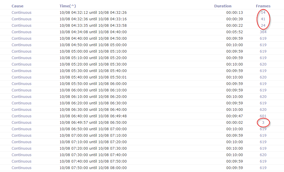

I am trying to figure out if this is a camera issue or a zoneminder issue.
I am missing frames from time to time although it is set to continuous recording.
I have zoneminder 1.32 with cheap chinese cameras Herospeed. Everything works fine H264, H265 but I just get these random cutouts.
The cameras are set to H265+ now
Any ideas are welcome.

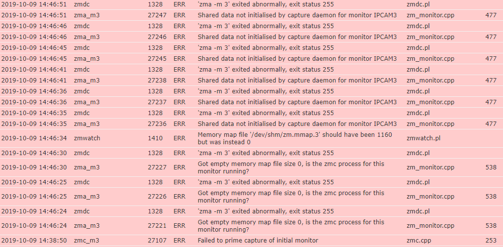

I did not have time yet for a fresdh install of 1.33 but I managed to get a log from a hiccup :)
Any ideas ?
