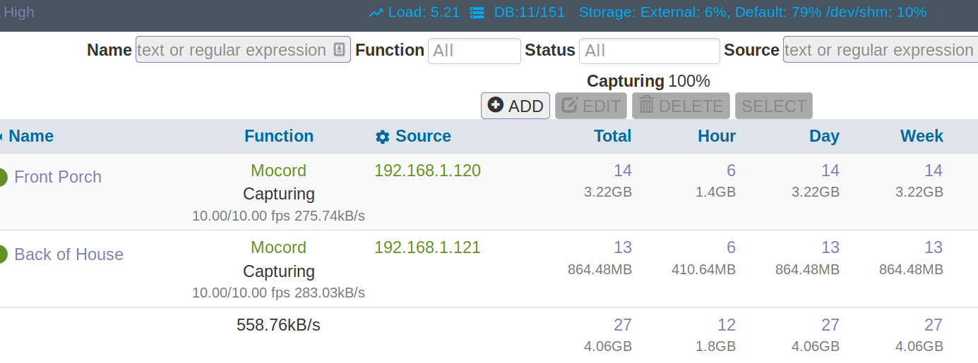

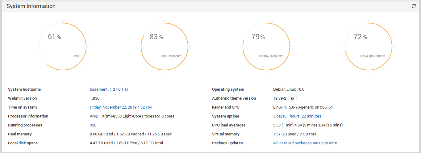

See the screen shots for my hardware and my high load.
I have both cameras set to 10fps.
Screenshot from 2019-11-22 16-35-41.png (69.84 KiB) Viewed 2237 times
Screenshot from 2019-11-22 16-33-25.png (55.57 KiB) Viewed 2237 times

1) Use H264 passthrough instead of JPEG or H264 encode.
2) Disable prefetch mitigations, see: http://forums.zoneminder.com/viewtopic.php?f=11&t=28292
3) Make detection zones smaller.

H264 pass through set on the cameras has me at 1.09 load now.
