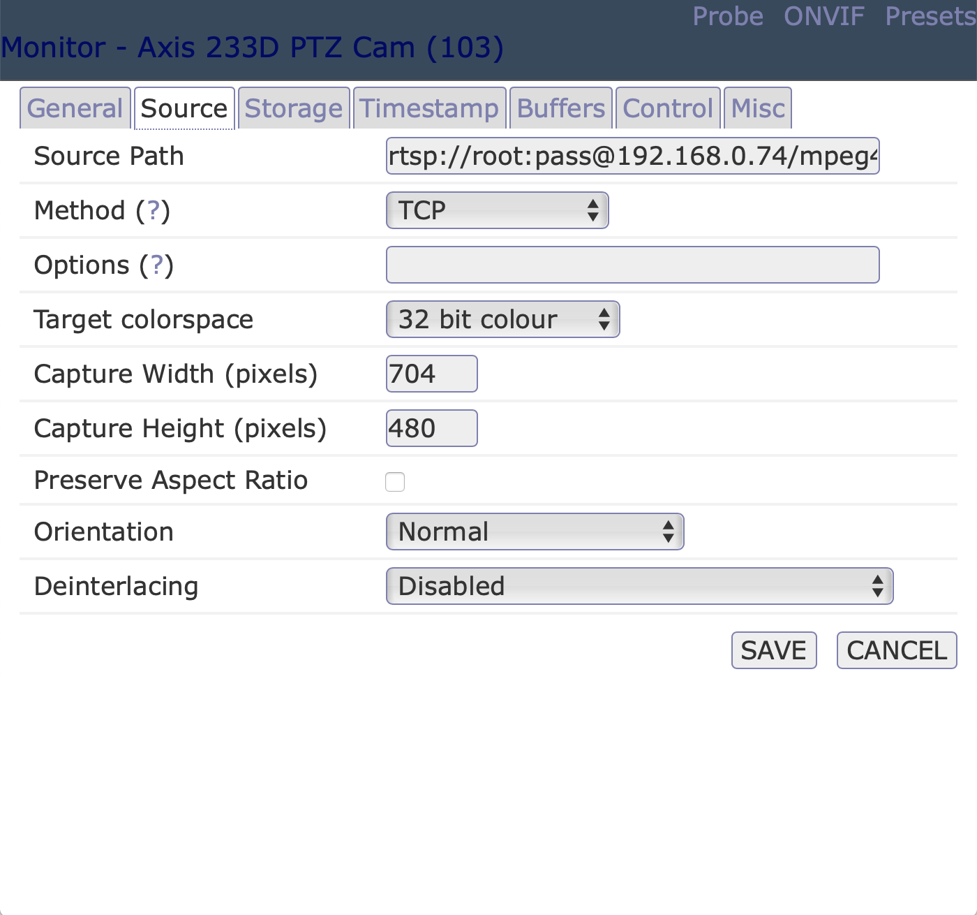

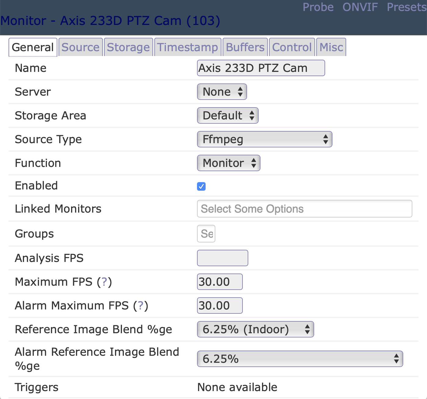

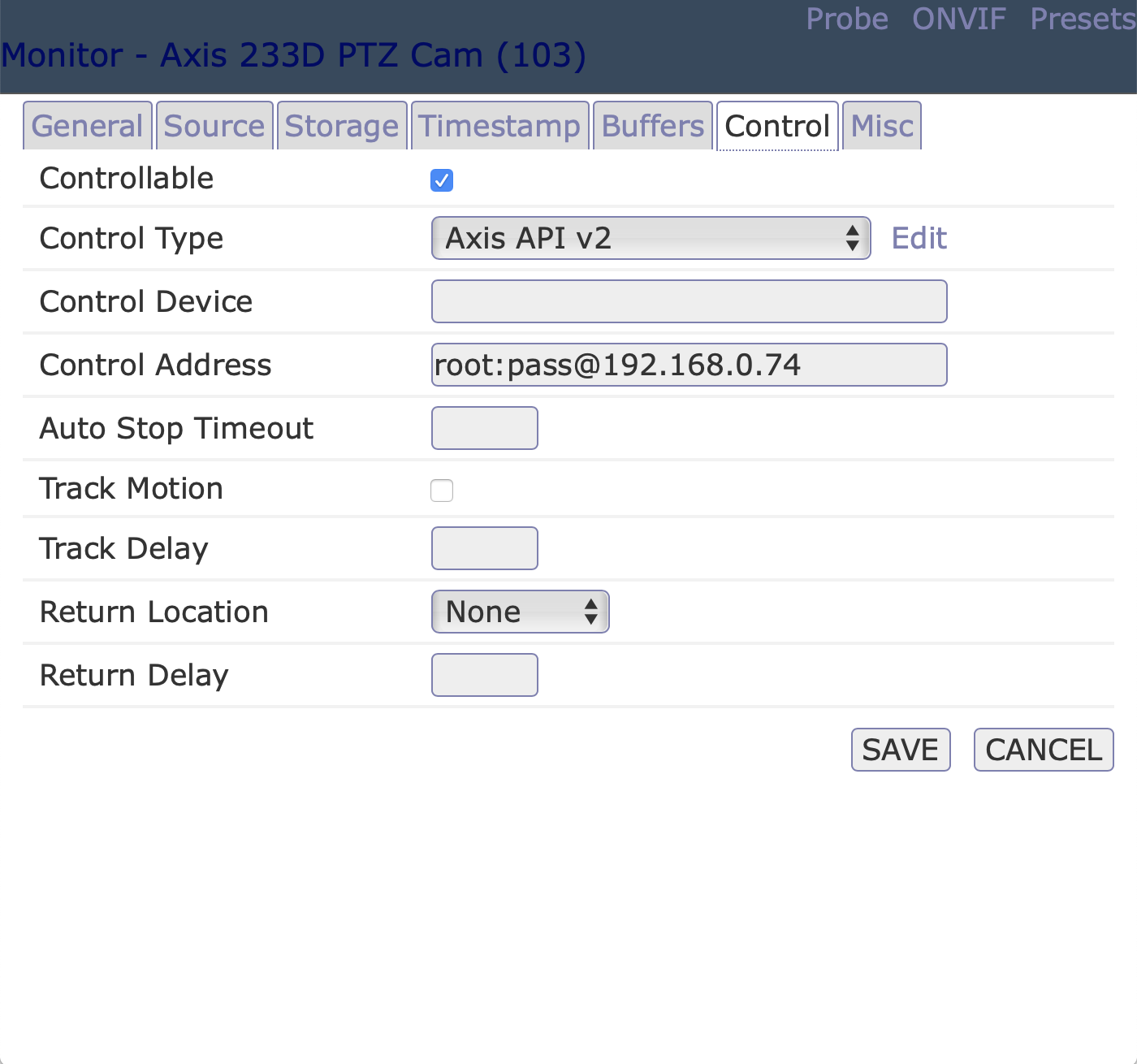

I'm trying to get Zoneminder set up to control an Axis 223D PTZ camera. I was able to get the video feed off the camera just fine using RTSP, but I'm unable to get Zoneminder to PTZ control the thing using the Axis API V2 script.
If I open up a terminal on my Zoneminder server and copy commands out of the AxisV2.pm script and send them to my camera using curl, the camera moves.
For example if I send the following using curl from my server the camera moves right
curl http://root:pass@192.168.0.74/axis-cgi/com/ptz.cgi?move=right
I decided to run a packet capture on the traffic between my Zoneminder server and my Axis 223D to make sure Zoneminder was actually passing the HTTP control commands. I found no HTTP / port 80 in the traffic between the server and camera only RTSP. So I can only assume that for some reason Zoneminder is not actually sending the commands to the camera when I click on the arrows in the monitor feed.

Ive added two more Axis PTZ cams to Zoneminder, the Axis V2 script doesn't work with either of them.

I took a quick look with an online demo camera... it may be that we need to request control before actually sending the control commands.

If it was necessary to request control of the camera, I don't think sending the commands to the camera via cURL would work.
Also from the packet capture I ran Zoneminder is not actually sending the commands to the camera. I made sure the Ubuntu UFW was switched off for testing. Other than that I'm not sure how to troubleshoot this.

So I kind of got this working.
I had to adjust my firewall settings on my router to allow the PTZ commands from the zone minder server to get to the cameras.
I'm able to control the cameras if I use ZMNinja, but not from the webconsole.
So the cameras are controllable via API calls but not via how ever the web console controls the cameras.
Does anyone have ideas on this?
Also what permissions should /usr/share/perl5/ZoneMinder/Control have?
I did a chmod 777 and chown -R www-data:www-data on that folder for testing

So when I open up the console on my browser and click on one of the PTZ control arrows I get these messages in the console output
[Error] Origin https://zm.mydoamin.com is not allowed by Access-Control-Allow-Origin.
[Error] XMLHttpRequest cannot load https://zm.mydoamin.com:30107/zm/index.php?view=request&request=stream&connkey=653755&auth=89102f77f4c563b6cbfe876d1417cb26&command=99 due to access control checks.
[Error] Failed to load resource: Origin https://zm.mydoamin.com is not allowed by Access-Control-Allow-Origin. (index.php, line 0)
Can anyone help me?
Posts: 3361
Re: Axis 233D PTZ control
This looks like a problem with our CORS setup. You are using multi-port but not multi-server I assume.
Update to 1.33.15. I fixed some issues that may relate.
