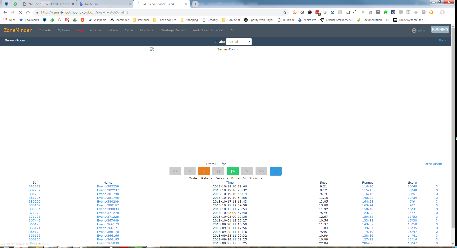

I updated from 1.30.4 to 1.32.2. Zoneminder claims it is running, but the cameras do not show any images.
I went to check that the PATH_ZMS value is correct (as i've done historically and still referred in the Log file) and it seems that this version has dropped the Path tab pane from Options. It doesn't even work if you set the query string to ?view=options&tab=paths
Has this been deliberately moved or just missed by accident?

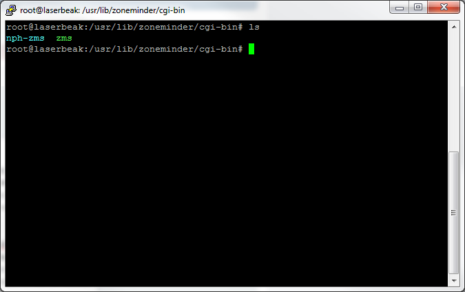

Ok, that's all correct (see attached).
If that's the case, what is causing the issue in the third screenshot. It has the associated log errors.
2018-11-05 14:27:55 web_php 32108 ERR Socket /var/run/zm/zms-813859s.sock does not exist. This file is created by zms, and since it does not exist, either zms did not run, or zms exited early. Please check your zms logs and ensure that CGI is enabled in apache and check that the PATH_ZMS is set correctly. Make sure that ZM is actually recording. If you are trying to view a live stream and the capture process (zmc) is not running then zms will exit. Please go to http://zoneminder.readthedocs.io/en/lat ... window-etc for more information. /usr/share/zoneminder/www/includes/functions.php 2043
2018-11-05 14:27:55 web_js 32108 ERR getStreamCmdResponse stream error: Socket /var/run/zm/zms-813859s.sock does not exist. This file is created by zms, and since it does not exist, either zms did not run, or zms exited early. Please check your zms logs and ensure that CGI is enabled in apache and check that the PATH_ZMS is set correctly. Make sure that ZM is actually recording. If you are trying to view a live stream and the capture process (zmc) is not running then zms will exit. Please go to http://zoneminder.readthedocs.io/en/lat ... window-etc for more information. - checkStreamForErrors() ?view=watch
- Screenshot 2018-11-05 14.32.00.png (37.67 KiB) Viewed 63452 times
- Screenshot 2018-11-05 14.31.12.png (21.76 KiB) Viewed 63452 times
- Screenshot 2018-11-05 14.27.51.png (150 KiB) Viewed 63452 times
