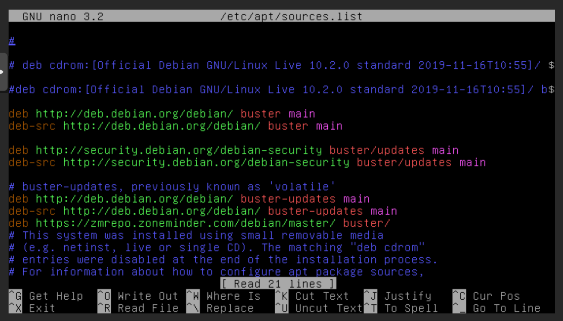

I am working on installing zoneminder on Debian, but are having some issues.
I am following this guide: https://wiki.zoneminder.com/Debian_10_B ... pro_Master
Everything works fine, untill I try to run the sudo apt install zoneminder, which gives me the error: E: Unable to locate package zoneminder.
This is what my sources.list looks like:
Can anybody see, what I am doing wrong?

Ran that install yesterday on a Pi 3b+ with Buster. Had no issues. Make sure the wget command completes. Also best to become root with sudo su and leave out the sudo on the commands.

Posts: 3403
Re: Help needed for installation
I think you have an extra /
the zmrepo line should be
deb https://zmrepo.zoneminder.com/debian/master buster/
note the lack of / after master.
Posts: 2981
iconnor wrote: Wed Dec 25, 2019 4:34 pm I think you have an extra /
It is correct in the WIKI.
