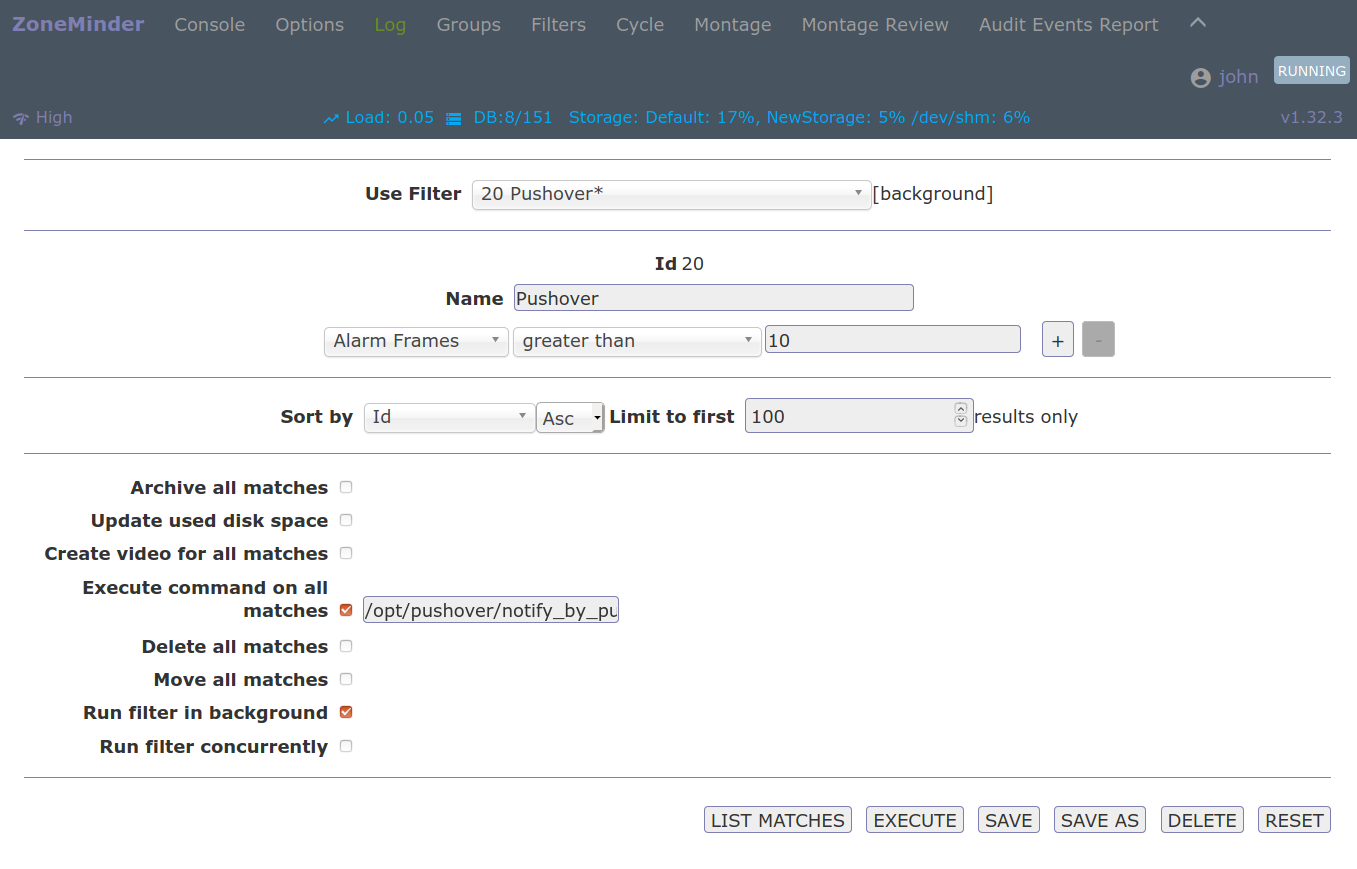

Hi Folks,
I'm running Version: 1.32.3-stretch on Debian GNU/Linux 9.11 (stretch), installed via https://zoneminder.readthedocs.io/en/la ... an-stretch (deb https://zmrepo.zoneminder.com/debian/release stretch/).
Runs well, records events from motion detection.
I configured a Pushover filter from https://www.jens.bruntt.dk/zoneminder-w ... fications/. I can't get the filter to run in the background.
Using List Matches from the filters page displays events correctly. Running Execute from the page fires off Pushover messages to my phone immediately.
In the syslog, i can see [Checking filter PurgeWhenFull delete returned 0 events ] and [Checking filter Update DiskSpace update disk space returned 0 events ], but no sign of Pushover filter.
If i run zmfilter.pl any events are sent immediately, and i can see [Checking filter Pushover execute returned 0 events ] as well as the 2 built-in filters running periodically.
I have attached the syslog tail, and the output from running zmfilter.pl, and a screenshot of the Pushover filter.
Obviously i have missed something, and wonder if anyone could help out?

Re: zmfilter.pl not starting
Did you restart zm after saving your filter? In 1.33 I made it auto-restart zmfilter, but in 1.32 it requires manual restart.
@iconnor, Okay, that did it. Restarting the service activated Pushover immediately.
I did a motion test and received Pushover messages.
Thanks very much. Should i have read that in the manual? I don't remember seeing that a restart was necessary.
Regards, and thanks again for both the great software and the speedy support!
