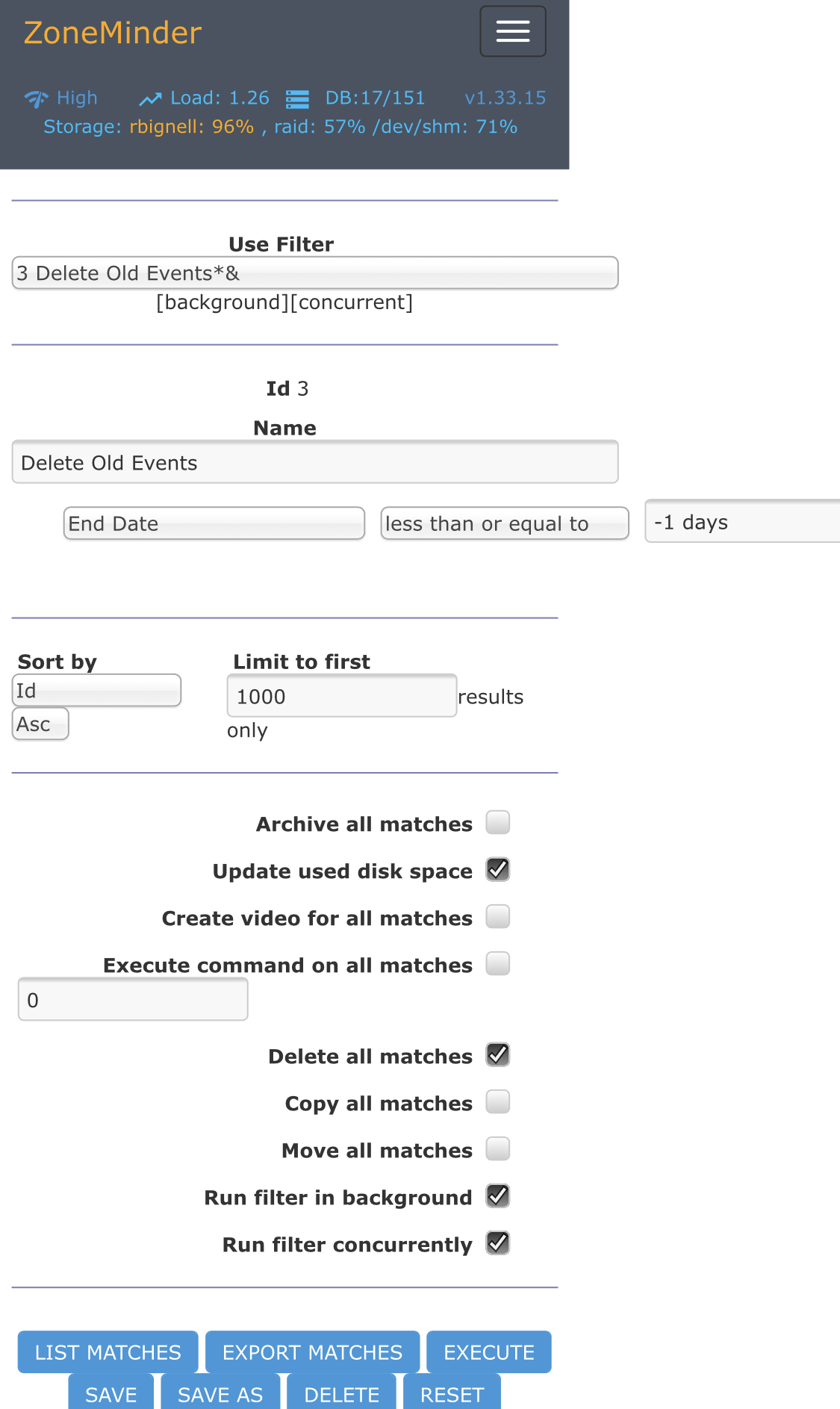

I tried -3 days and delete all events but the disk continues to fill up. I keep having to manually go and delete the events folders from the server. The filter finds events and seems to be clearing from the dB but I’m not sure it’s deleting them from the server.
I tried -1 days and it’s the same.
Disk filling up
Disk filling up

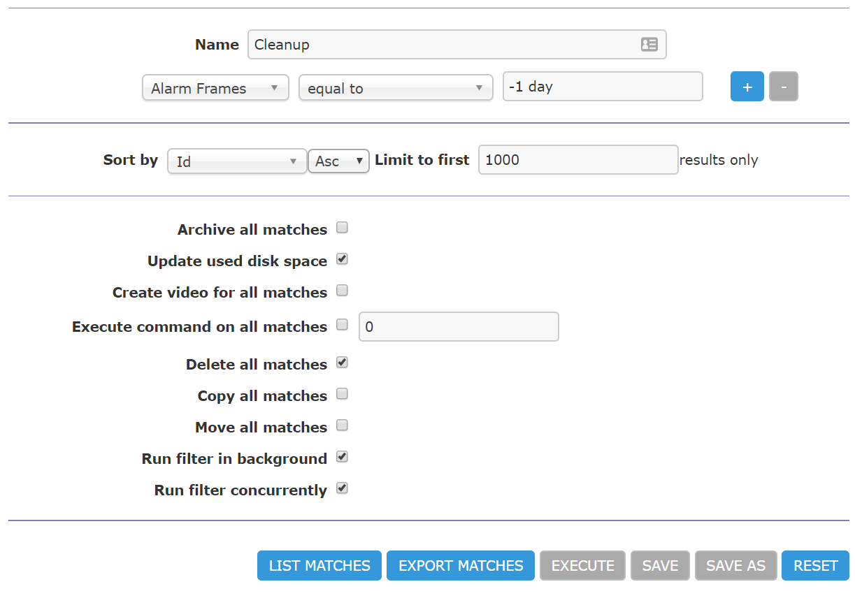

Is your question, why the disk fills up, or if the filter is not working ?
I have mine set to "-N day" NOT "-n days" , not sure if this makes a difference.
Secondly, I have mine set to "alarm frames, less than or equal to"
Re: Disk filling up
I tried day and days its still not deleting them from the disk so its filling up.
If i set to alarm frames i get zero matches.
Upgraded to 1.34 but still the same.
As you can see there are folders more than 3 days old containing events.

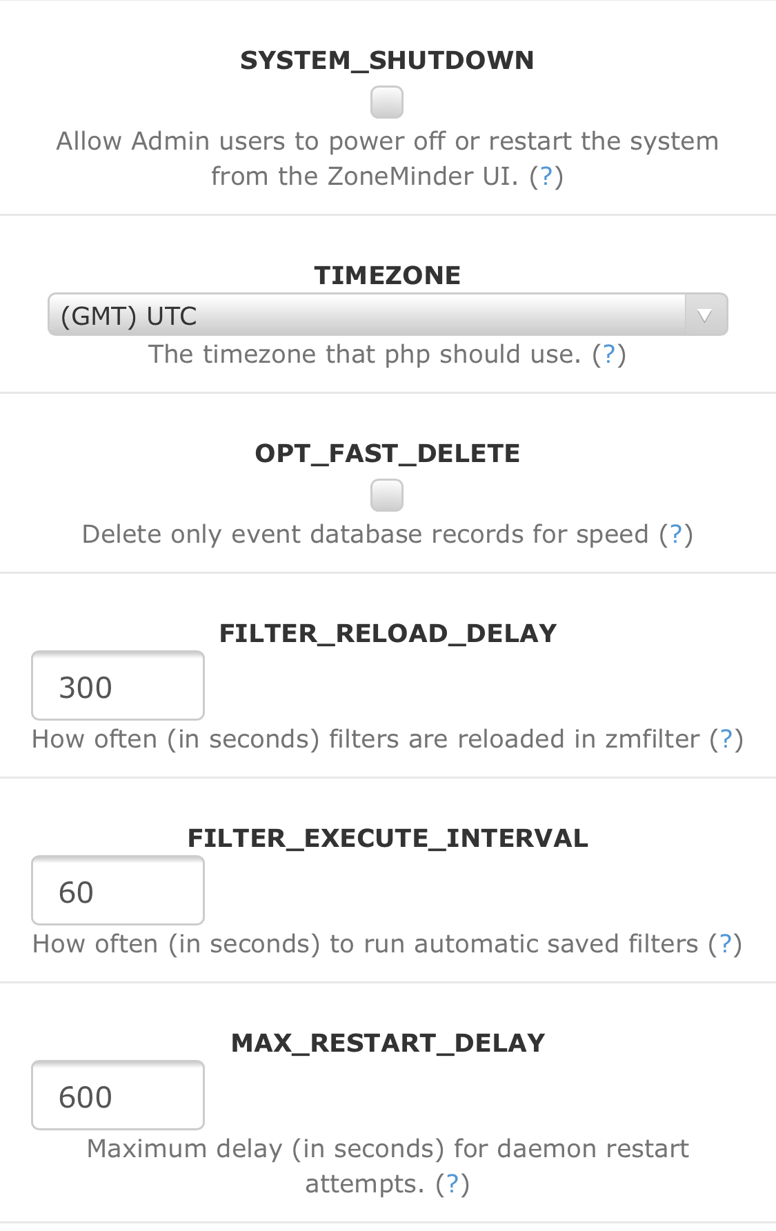

Re: Disk filling up
If the filter is only deleting the db entry then you have Options -> System -> OPT_FAST_DELETE checked. Uncheck it.
You probably do not want the filter to run concurrently.

Re: Disk filling up
I checked that checkbox and fast delete is not selected and if symlinks make no difference maybe I have a different issue.
