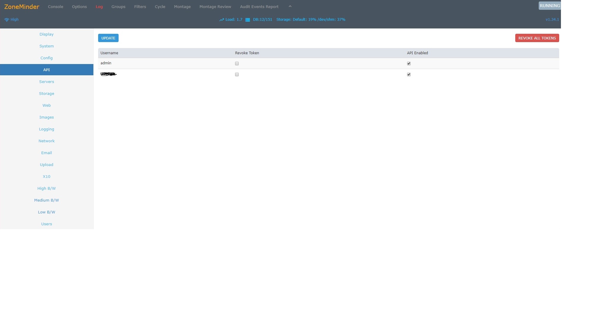

Did you enable the api for the user?
Re: Fresh install of 1.34 into Ubuntu 18.04 LTS - API 401 Error
Yes,API is enabled as shown in the attached printscreen,but I get 401 error for every url /zm/api/*
Thanks !
