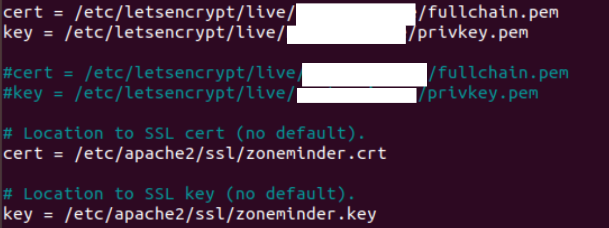

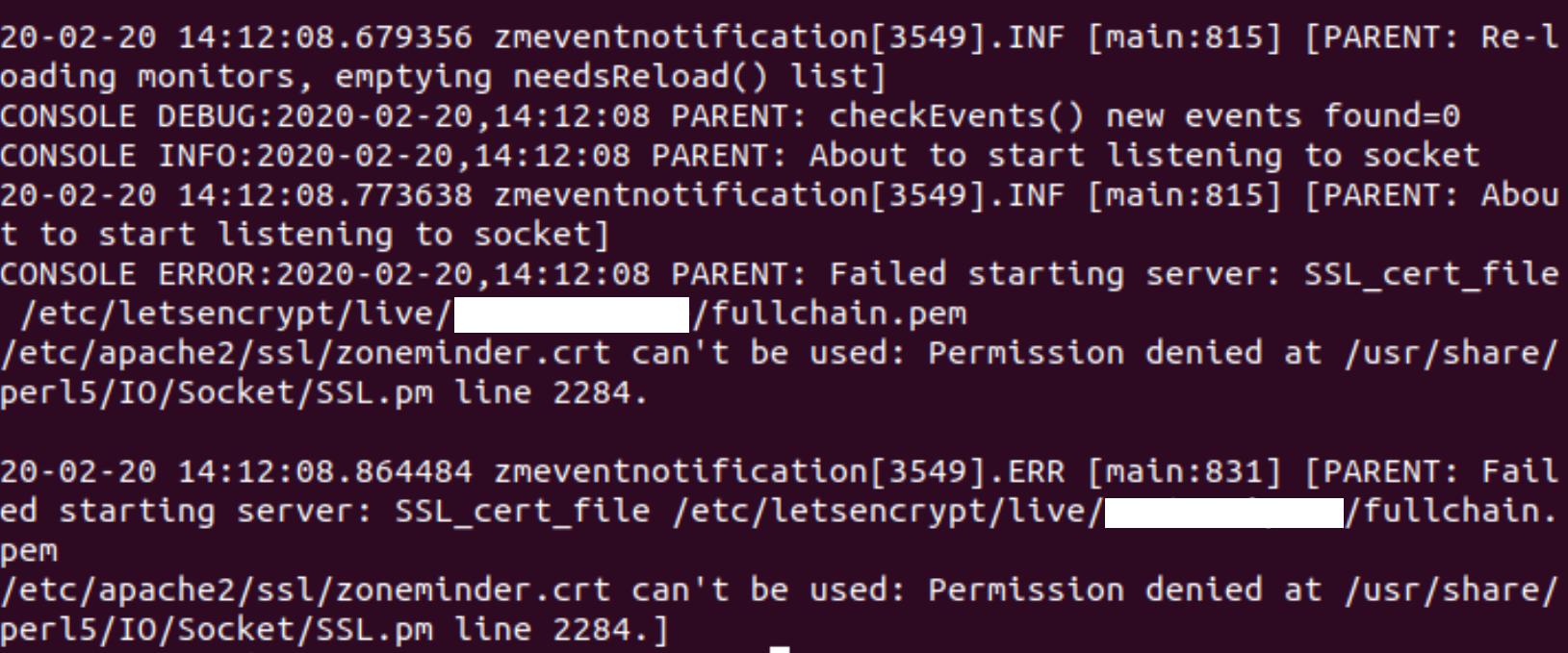

Can somebody help me with this error?
When I run this command to test the event server manual "sudo -u www-data ./zmeventnotification.pl --config ./zmeventnotification.ini"
Thanks!

Re: Zmninja Certification error
thanks for the reply.
So my settings are correct?
I tried this but still the same issue.
For this scenario, this should have been enough!
sudo chown -R www-data:root /etc/letsencrypt/
I did above and the manual start was working fine.
