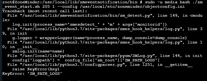

Anyone seen an error like this one before and got around it?
I'm working in a freenas jail with zoneminder 1.32.3 with apache.
Had some trouble getting the API running but I've fixed that now
I did have to edit ZMLog.py to get this far as it was complaining that my zm.conf couldn't be found in /etc/zm/zm.conf (it's at /usr/local/etc/zm.conf)
I'm wondering if there's more edits to these files that need to be made, but I would have thought it should be picking this up from config files somewhere else?
Thanks for any help!

You can't pass --config to zm_event_start.sh.
That is a parameter for zmdetect.py
If you are invoking zm_event_start.sh, edit that file and change CONFIG_FILE
With respect to logging, that is correct, by default it assumes "/etc/zm". You can change zm_detect.py "log.init" statements to override the conf_path https://github.com/pliablepixels/pyzm/b ... Log.py#L71

I've got logpath overridden to /var/log/zm in the args and conf_path changed to /usr/local/etc already but it still seemed to be having an issue with ZM_PATH_LOGS as if it's not defined or something.
Then I noticed the line
for f in glob.glob(config['conf_path']+'/conf.d/*.conf'):
realised it wasn't picking up my extra config files so changed that to
for f in glob.glob(config['conf_path']+'/zoneminder/*.conf'):
Which has moved things along a bit although now I'm getting this;
File "/usr/local/lib/python3.7/site-packages/pyzm/ZMLog.py", in line 162 in init config_table = meta.tables[Config]
KeyError: 'Config'
looking at the code it definitely looks like that's getting defined though.
Thanks so much for the help!

In ZMLogs.py I had to change;
config_table = meta.tables['Config']
log_table = meta.tables['Logs']
To
config_table = meta.tables['config']
log_table = meta.tables['logs']
no errors now and nothing returned in the console... which I guess is correct behaviour? No boxes around people in zmninja desktop yet but I'm guessing I just need to mess around with objectconfig.ini to get that working next.
Although please let me know if you think doing this might have messed something up somewhere :)
