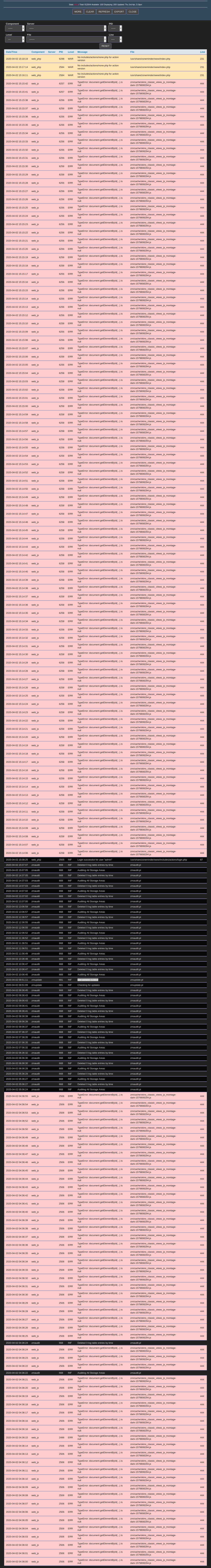

The below image shows the kind of errors I'm getting whilst attempting to get Montage view to display. Seems to be non-existent DOM elements?
More often than not, the only monitor which displays is the source which is in an error state in the console. :?
There's also three new, confusing warning messages at the top that I've never seen before.
ZoneMinder log (Montage & new errors)
Screenshot_2020-04-02 ZM - System Log.jpg (798.42 KiB) Viewed 2473 times
It worked for a short time, then last I checked montage is pretty much empty. :(

This is a pretty special situation. I have no idea what you have done to your system to get here, but I'll be looking over your previous posts looking for clues.
the view=none case is special, and should just close the window. Not log those errors. I will be reviewing the code.

iconnor wrote: Thu Apr 02, 2020 11:17 pm This is a pretty special situation. I have no idea what you have done to your system to get here, but I'll be looking over your previous posts looking for clues.
I freely admit, I don't have a vanilla, out-of-the-box OS install. I mean, I have added packages and configured my applications as per my own preferences, but I suppose that's about average for most users, right? :lol:
I was thinking maybe it was a privacy add-on which was blocking in-line script insertions/injections (?? maybe causing the getElementById() calls to fail? It was sporadic, so idk...). I have currently deactivated the add-on (FF: Privacy Badger) for my ZM server to see the effect. Montage is currently working again. I will update if anything changes. :mrgreen:
OOI, does ZoneMinder inject in-line script elements? If so, can it be done without inserting script blocks?

I suppose I could install privacy badger and see for myself. We generally stay aware from inline js. There are still a few though.

confirmed with privacy badger the cgi image streams don't happen... lots of CSP reports...
