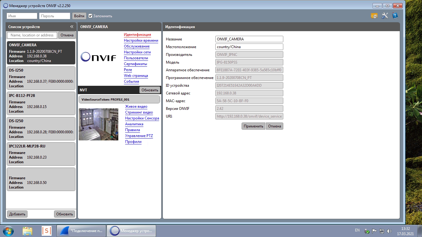

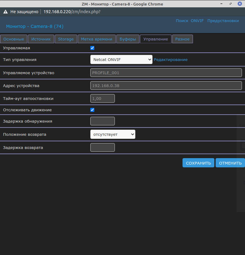

Greetings to all! Guys, help start a PTZ on such a camera. I can't do it.
UPD:
Immediately I apologize for my English - this is all google translator.)) (You have the latest version of ZoneMinder installed, v1.34.23) - my server. Cameras in the production of automatic doors. There are almost 100 of them in the installation.
I managed to get this PTZ camera in the following steps. Hope it comes in handy for someone here!
I only fixed this parameter in the original Netcat.pm file:
I had - my $ cmd = 'onvif / PTZ';
Fixed on - my $ cmd = 'onvif / ptz_service';
And control settings as in the screenshot that I attached.
Thanks to all! Because I took all the ideas from this topic.
Everything works in both ZM and ZMninjapro.

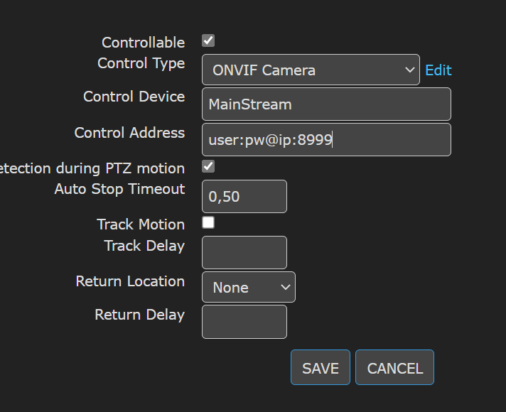

For those of you, who were not successfull (like me)..
Here is an updated onvif.pm and the settings I used... Took me 2 days of sniffing
MainStream has to be written with a big S!!!
Best luck for you guys...
Main changes in onvif I did - fixed the datetime function slightly and added/changed URI /onvif/ptz_service
replace your onvif.pm in /usr/share/perl5/ZoneMinder/Control/ with this one, and it should work....
