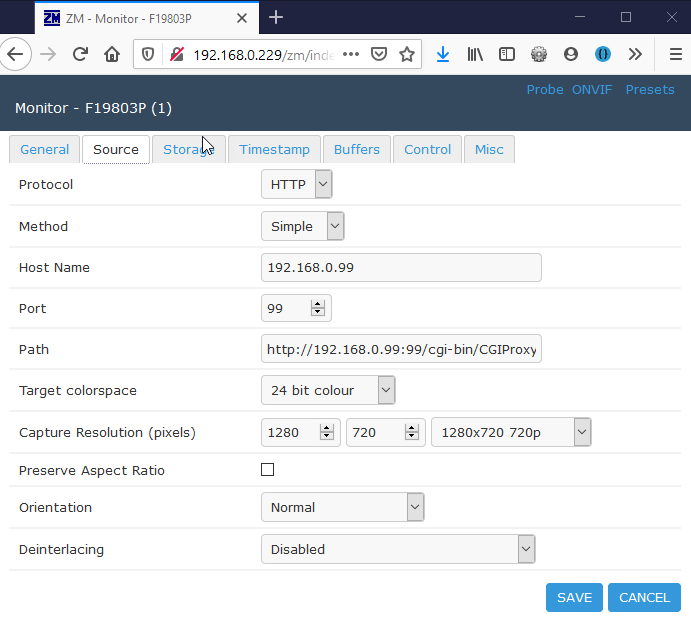

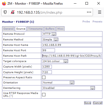

I have now running zm version 1.29 on a Pi3.
I'am installing a new pi4 with Zm version 1.34.10.
In attach the 2 configurations.
Both are set exact the same values but the new version is not working.
I have copied the settings from the working camera to the new version.
Below a part of the log file.
2020-05-01 11:09:18 zmc_m1 14335 ERR Unrecognised content type 'text/plain' zm_remote_camera_http.cpp 848
2020-05-01 11:09:18 zmc_m1 14335 ERR Unable to get response, disconnecting zm_remote_camera_http.cpp 1085
2020-05-01 11:09:18 zmc_m1 14335 INF Return from Capture (-1), signal loss zm_monitor.cpp 2454
2020-05-01 11:09:18 zmc_m1 14335 INF Failed to capture image from monitor 1 F19803P (1/1) zmc.cpp 317
2020-05-01 11:09:13 zmc_m1 14335 ERR Unrecognised content type 'text/plain' zm_remote_camera_http.cpp 848
2020-05-01 11:09:13 zmc_m1 14335 ERR Unable to get response, disconnecting zm_remote_camera_http.cpp 1085
2020-05-01 11:09:13 zmc_m1 14335 INF Return from Capture (-1), signal loss zm_monitor.cpp 2454
What can be wrong in this configuration.
I use a Foscam F19803P camera.
The small figure is the working version
- working2.png (22.2 KiB) Viewed 5017 times
- ZM v1.34.10
- NOTworking2.png (36.39 KiB) Viewed 5017 times

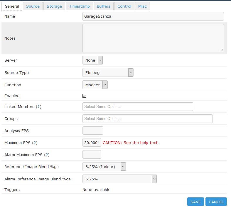

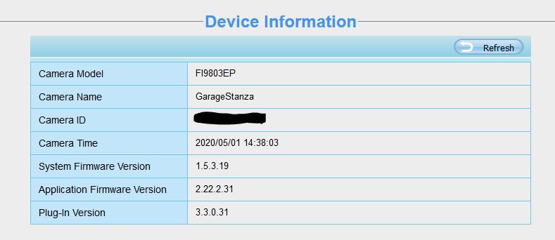

Re: what' wrong?
I've got the same camera and it's working.
I attached screenshots with configs.
On the source path line where I darkened you have to write "username:password"
- Cattura2.JPG (54.01 KiB) Viewed 5010 times
- Cattura.JPG (59.21 KiB) Viewed 5010 times

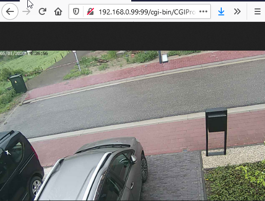

Thanks,
I have put the setting like yours (with my username password), but is still not showing an image.
Is there a way to test it another way?
I have tried in VLC and it is not working there also.
BUT, when i use the path "http://192.168.0.99:99/cgi-bin/CGIProxy ... &pwd=xxxxx&" in a browser, its working.
What do i missing?
Herman
What do i missing?
Herman
