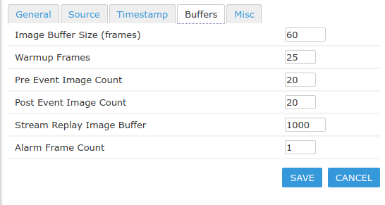

marcmerlin wrote: Wed Apr 18, 2018 4:53 pm ... but generally isn't there a setting to have ZM rewind and show a fair amount of frame before an alarm? Or once something is tagged as bulk, there is no going back and allowing to have ZM unbulk it?
There is the pre-event buffer. It's basically the number of frames to keep pre-event frame. It is a frame count, so the frame rate of your camera will determine how much "time" is recorded pre-event.
Screenshot at 2018-04-20 13-48-54.png (20.07 KiB) Viewed 8929 times

Thanks Pedulla, I forgot where it was. Indeed that's what I was referring to.
This does not work with mocord and bulk frames either.
I get no pre-alarm frames in many cases (if not all) and my prevent image count is 25 (which I think is the default)
