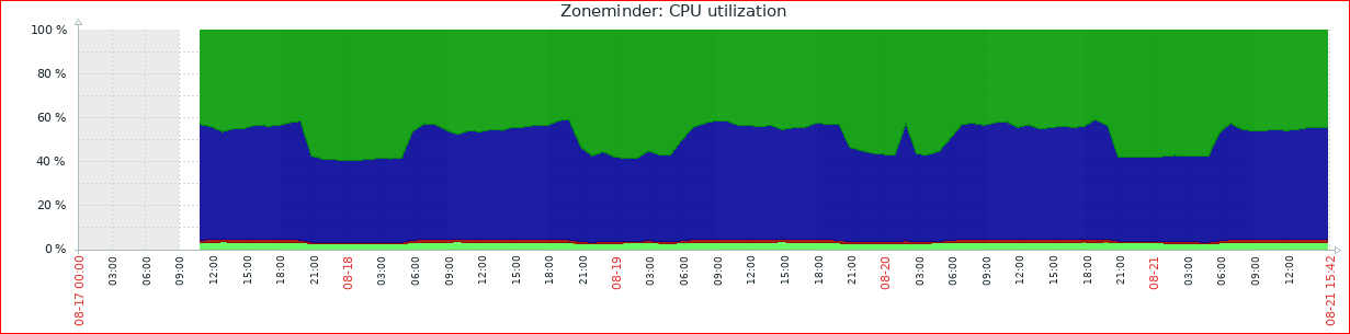

I need some help as I need to expand my monitoring solution and based on my math I don't have enough power. Currently all is running great but I need to double the cameras and now CPU usage is 60%
CPU USAGE
CPU USAGE
CPU Zoneminder.PNG (25.27 KiB) Viewed 3696 times
I have an old Dell Optiplex 980 with an i5 3.20GHz with 12GB RAM and a DELL SSD inside it running Debian 10.5

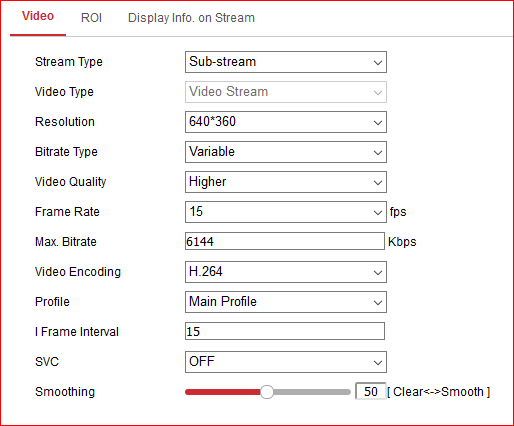

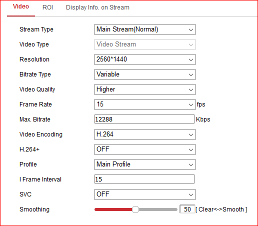

Cameras are 4 X Hikvision DS-2CD2043G0-I doing modect on low-res and the high res is linked to low-res one. Settings attached:
Low-res
Substream

Main one:
Main Stream
Main Stream
Main Stream.PNG (13.81 KiB) Viewed 3696 times
What else do you recommend but not to decrease the resolution / FPS. During night when is not too much movement and I have black and white due to IR it still doesn't go below 40%. Any other settings I can tweak in Zoneminder? Zones are as small as possible, covering maximum 25% / camera view.
