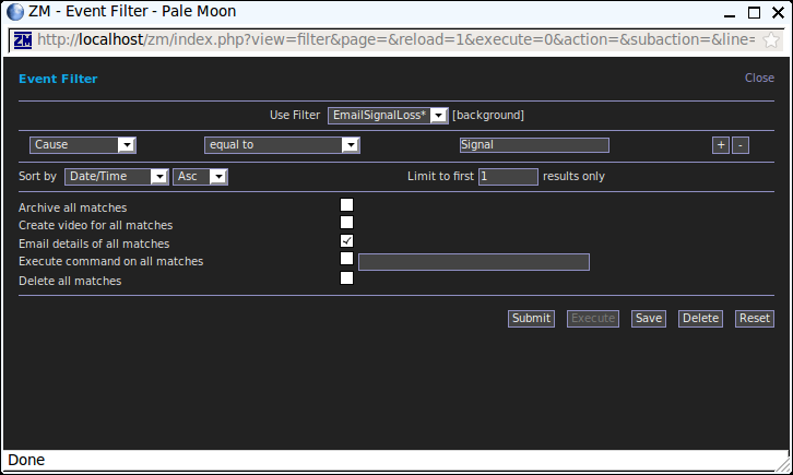

Hello all
Wanted to implement a way to be notified when the camera goes down .Kindly guide how the same can be done. Did searched the forum(attached image) as it mentions that it notifies when camera is online..do let me know as I wanted notifcation when camera goes down
