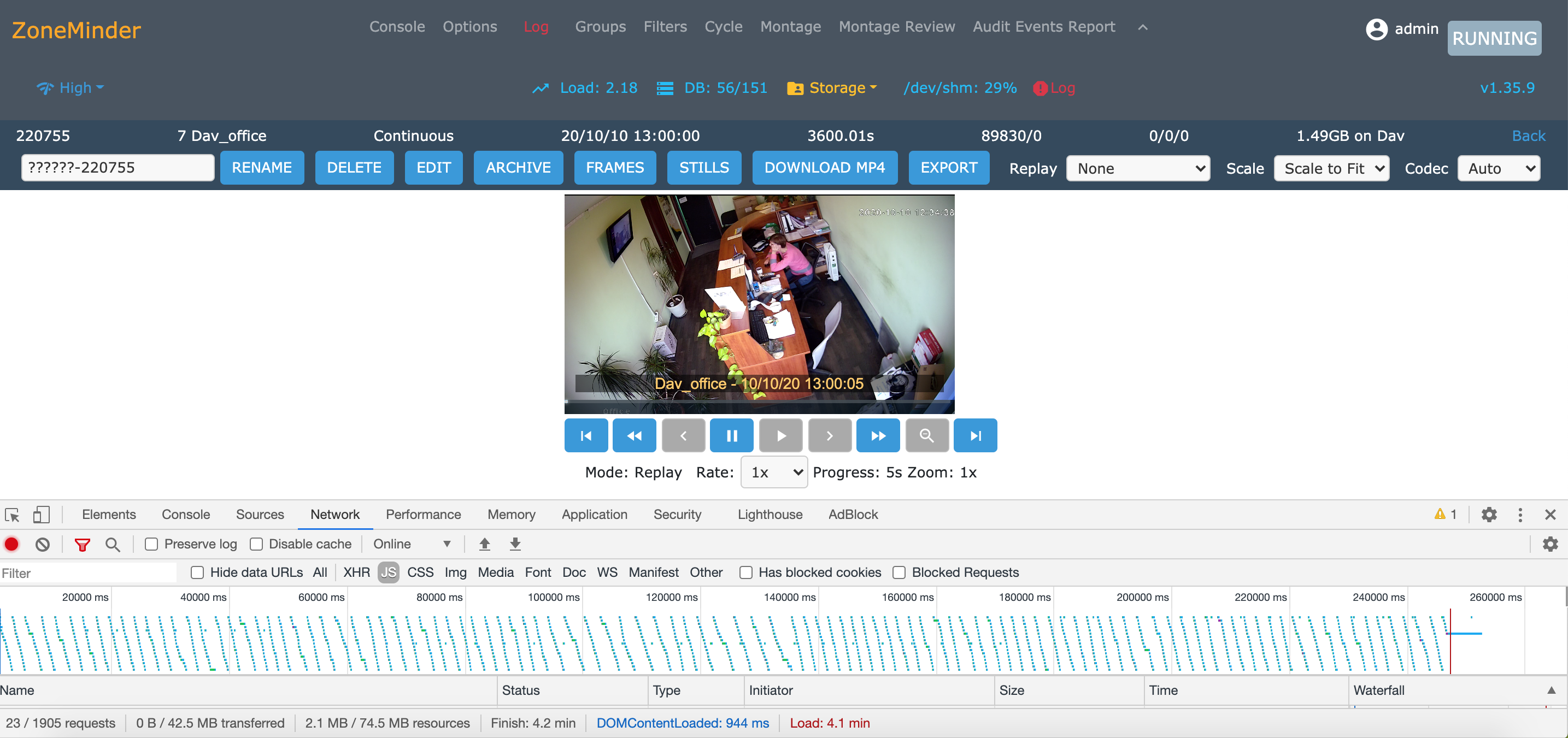

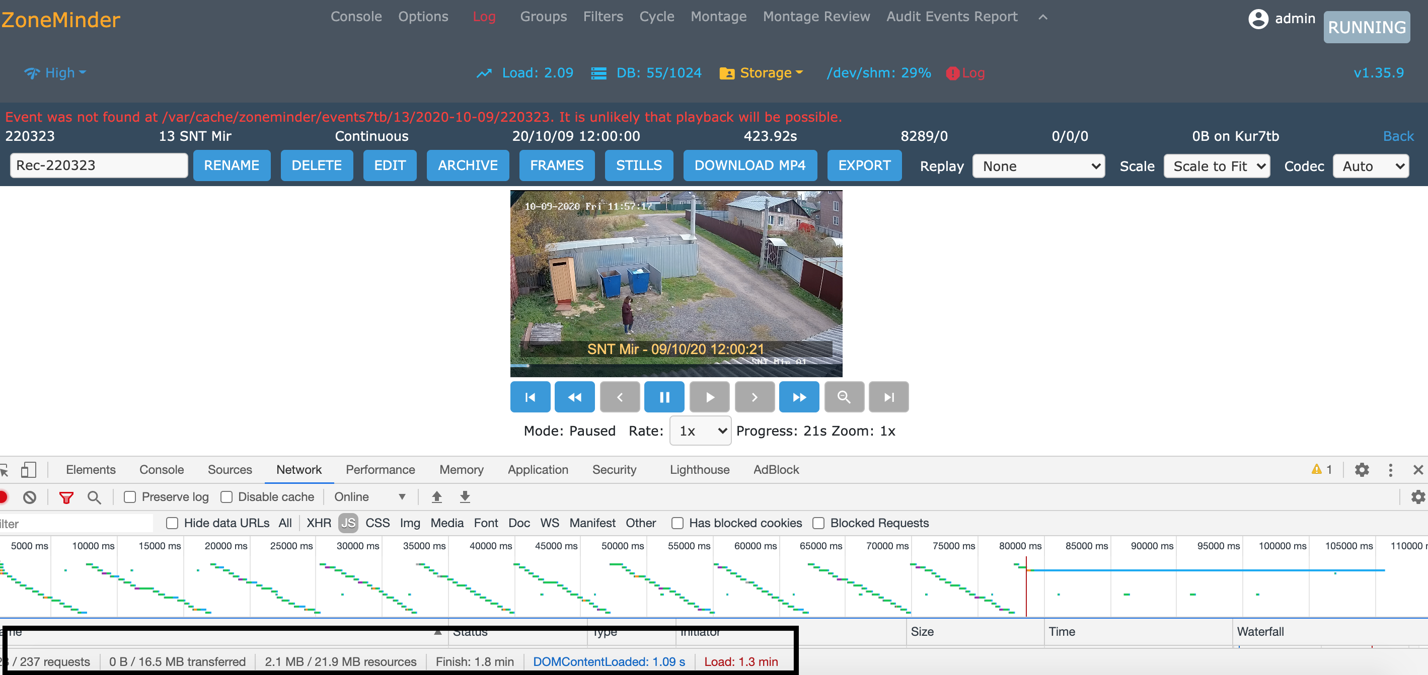

Cramac1
Posts: 111
Re: Cannot view events
Post by Cramac1 »
playback does not work
in web -
Event was not found at /var/cache/zoneminder/events7tb/13/2020-10-08/219873. It is unlikely that playback will be possible.
ver - 1.35.9~20201008094603-bionic

Cramac1
Posts: 111
Post by Cramac1 »
if you wait for a very long time, then something starts to show. Feeling that the file is loading slowly.

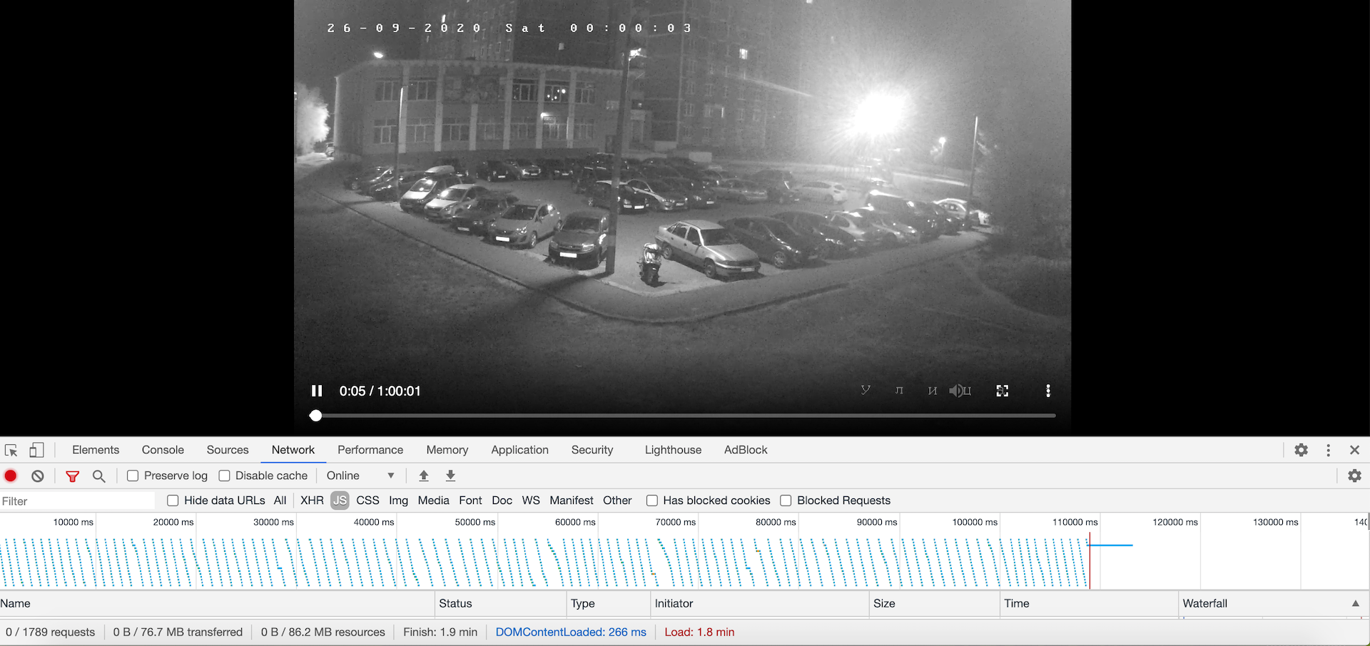

Post by Cramac1 »
tell me what happened. Three different servers, three different uplinks, the problem is the same everywhere. The entries began to open for a very long time. Both in the browser AND in the mobile application.
how to solve? where to look? Rollers for 5 minutes opens the video for an hour as before
Cramac1
Posts: 111
Post by Cramac1 »
site.com/video.mp4
time before the start of the show - 1.8m
site.com/zm/
time before the start of the show - 4.1m
