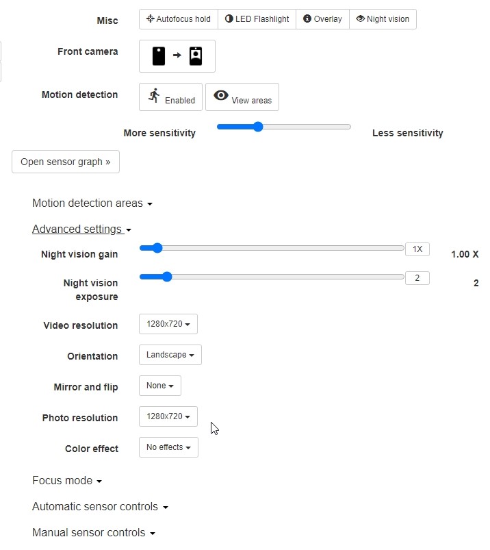

After you get it working on VLC look into the tools menu -> codec (Ctrl+J)
to get the exact resolution especially Android IP webcam have some "interesting" resolutions.
u can change that from the android app (video options)

ah thanks for the tips guys I got it working. Heres what it was:
Screen Shot 10-04-20 at 10.42 AM 06.JPG (79.44 KiB) Viewed 11293 times
the IP webcam software for android by Pavel Khlebovich 2013 version has a different area to set the resolution for JPEG's.
Hope this helps someone else!
