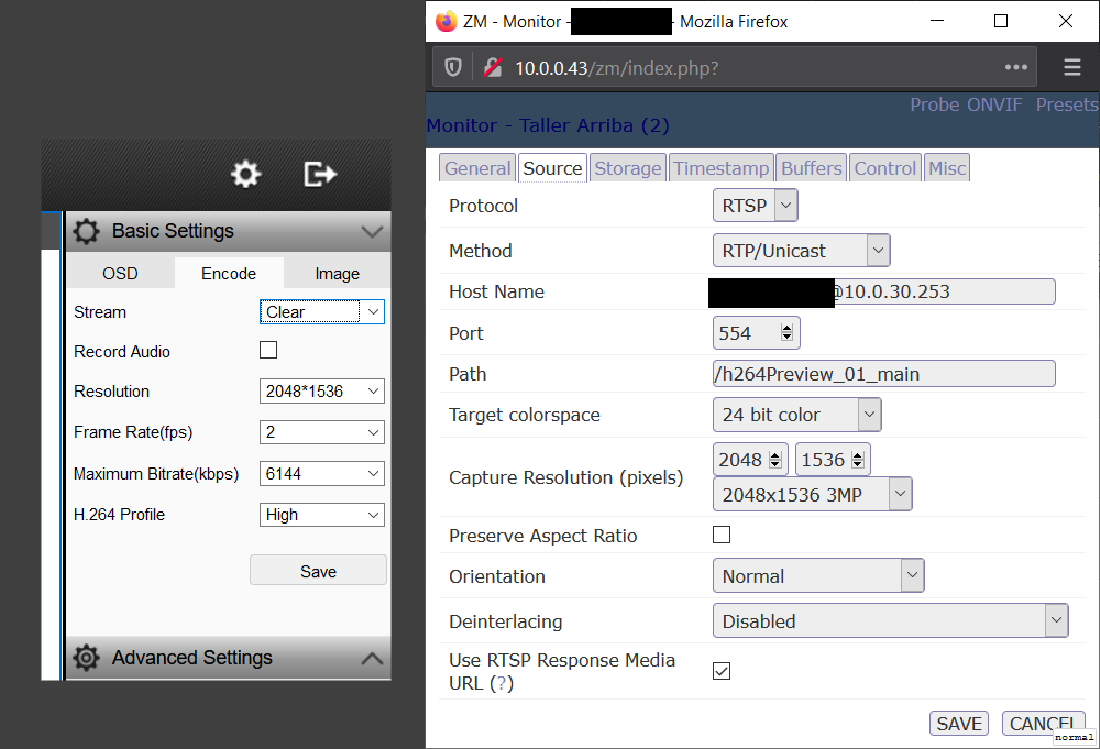

Using ZoneMinder 1.35 super happily for two months now.
I have two Reolink cameras.
In the cameras themselves, they're set at 2048x1536 and 2 fps.
In Zoneminder, I have them at 2048x1536 via RTP/Unicast.
I added a third Reolink camera, and I couldn't get it to show up.
All configurations were the same.
Yet when I lowered the resolution of this third cam, Zoneminder was able to start monitoring it.
Any general suggestions?
Maybe my server hardware?
What other info can I provide so you can make a better suggestion?

Sounds like you filled up /dev/shm
By the way, your screenshot is not from a recent version of 1.35.
df -h /dev/shm

I'll check /dev/shm!knight-of-ni wrote: ↑Fri Oct 16, 2020 1:16 am Sounds like you filled up /dev/shm
By the way, your screenshot is not from a recent version of 1.35.Code: Select all
df -h /dev/shm
Regarding v1.35... wow... sorry on my part.
I thought I was on the latest.
I'll upgrade today (if time permits).
