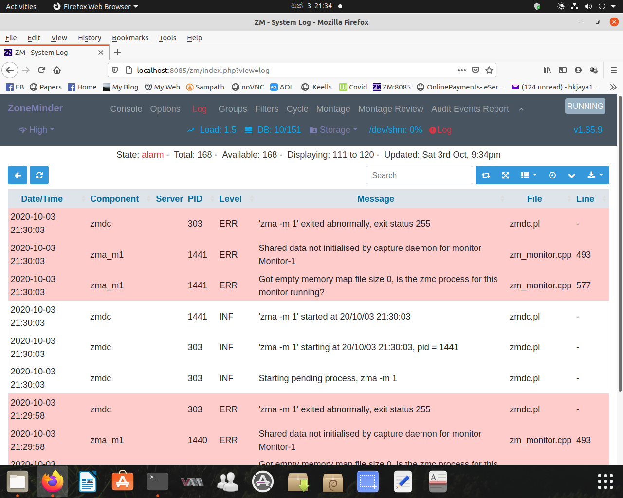

The button for deleting logs in log panel is missing in Zoneminder master 1.35.9~20201003115820-focal released today
Screenshot from 2020-10-03 21-32-45.png (365.53 KiB) Viewed 7362 times
Figure:- 1 No problem in creating monitors , emailing , uploading motion detection events
Screenshot from 2020-10-03 21-34-24.png (279.52 KiB) Viewed 7362 times
Figure:- 2 Delete Logs button is missing
I had to use the following terminal commands to delete the logs
mysql -uroot -ppassword zm
truncate table Logs;
quit

Re: Zoneminder master 1.35.9~20201003115820-focal - log delete button is missing
That's correct. I left that feature out. Can you describe a reason why someone would want to delete a specific number of log entries?
Note that log files are automatically purged by zmfilter, based on LOG_DATABASE_LIMIT under Options -> Logging. You can set this to either a max number for records, or specify a time limit.
Post by bkjaya1952 »
knight-of-ni wrote: Sat Oct 03, 2020 6:21 pm That's correct. I left that feature out. Can you describe a reason why someone would want to delete a specific number of log entries?
I was thinking about removing red color alarm at log button. :) .
Thank you Sir . I will use LOG_DATABASE_LIMIT to delete logs.
