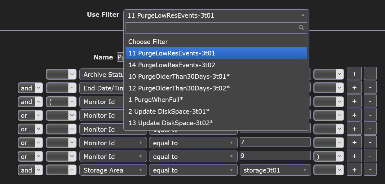

I've created a filter for each storage area (hard drive) I use, and it seems to work. The name of the field will be "Storage Area".thor95 wrote: ↑Fri Oct 23, 2020 3:20 am When I added the second drive I never changed the Purge filter. The system is purging the new, second hard drive correctly.
It is not purging the original, existing default drive any more.
I look in the Purge filter and there is no drop down that identifies specific hard drives.
Archive Status equal to Unarchived Only and Disk Percent greater or equal to 85.
There is nothing here that is specific to a particular drive.
- zm_filters_MultipleStorageLocations.png (97.73 KiB) Viewed 2618 times
