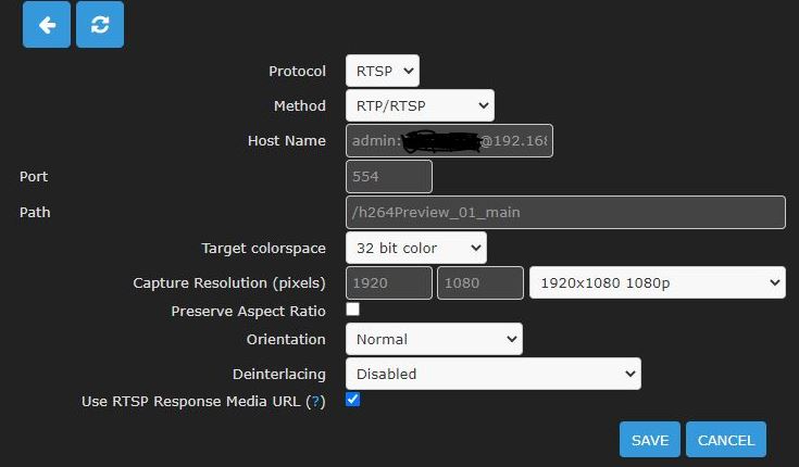

Re: Reolink RLC-410 Data Streams
I also tried this in Remote source type
- Capture.JPG (39.68 KiB) Viewed 132043 times
