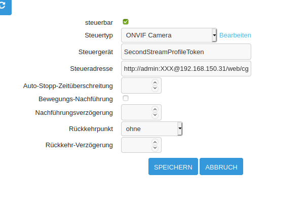

Hi.
How can I control an zilnk cam with zoneminder, i can't set a token (or did they mean the password). What is control adress?
I have /web/cgi-bin/hi3510/ptzctrl.cgi
i tried http://user:password@192.168.1.31
but that did not work. What can I do?
Re: Control of an zilnk cam
Try ONVIF.
Post by Andi79 »
i tried it, but it does not work
Try the Onvif Probe rather than the Onvif source type. It's a link on the top right of the monitor config.
Alternatively, use a third party tool like Onvif Device Manager (Windows):
https://sourceforge.net/projects/onvifdm/
This will determine a valid rtsp url for you, which you then use to create a monitor in ZoneMinder using the ffmpeg source type.
