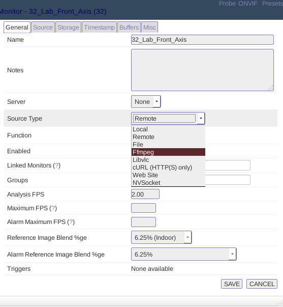

As for LibVLC, I believe it will be available as a Source Type if the dependencies are available when ZM is built. Debian and Ubuntu should have it as default since 1.32. Before that it might've required a manual install. libvlc-dev or something similar. Specific instruction were in one of the old wiki debian guides. But it shouldn't be needed now.
So it will depend upon what dist you are using. Anyways, use ffmpeg from terminal or VLC from gui and double check the resolution, as that is more likely the issue, based on above.
