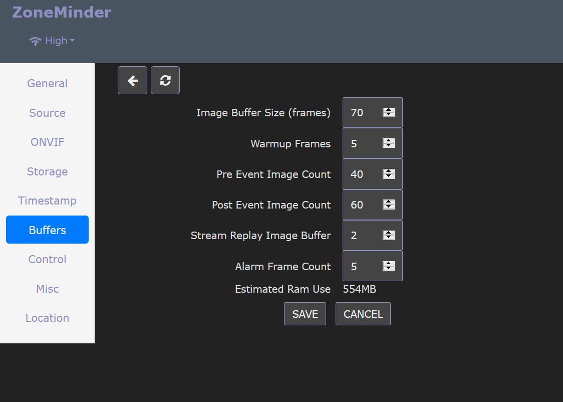

Re: Cannot use "8 hour" or view "all events"
Have you seen the bit about setting buffers to 2?
what buffers are you refering to?
now clicking on "8 hours" lead to a white website with no infomation what so ever. is there any other settings that require adjustment?
