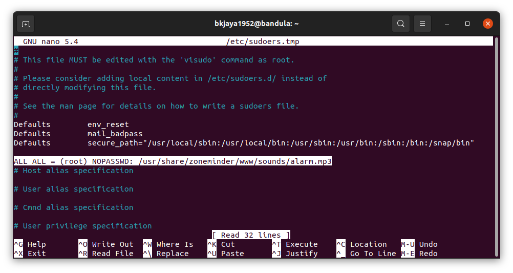

Please refer the following link https://bkjaya.wordpress.com/2020/11/08 ... -a-motion/ & try the following steps on the Ubuntu terminal
sudo chmod +x /usr/share/zoneminder/www/sounds/alarm.mp3
sudo vsudo
Then add the following line to the opened file and save
ALL ALL = (root) NOPASSWD: /usr/share/zoneminder/www/sounds/alarm.mp3
Screenshot from 2021-06-09 22-22-56.png (67.7 KiB) Viewed 6833 times
